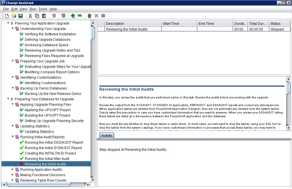

When you create a new upgrade job, you will see a job view similar to the following example:
This example illustrates the fields and controls on the Upgrade Job. You can find definitions for the fields and controls later on this page.
Upgrade Job

When you are ready to run your upgrade job, select Run from the Change Assistant toolbar. Monitor the status of the automated upgrade steps in the Step Details box. After a automated step is completed running in Change Assistant, you can view logs, scripts and update job properties for individual steps.
Change Assistant uses Application Designer and Data Mover in the background to perform many of the tasks. When using Change Assistant, make sure that any current Application Designer and Data Mover sessions running on the same workstation as Change Assistant are closed before running Change Assistant.
