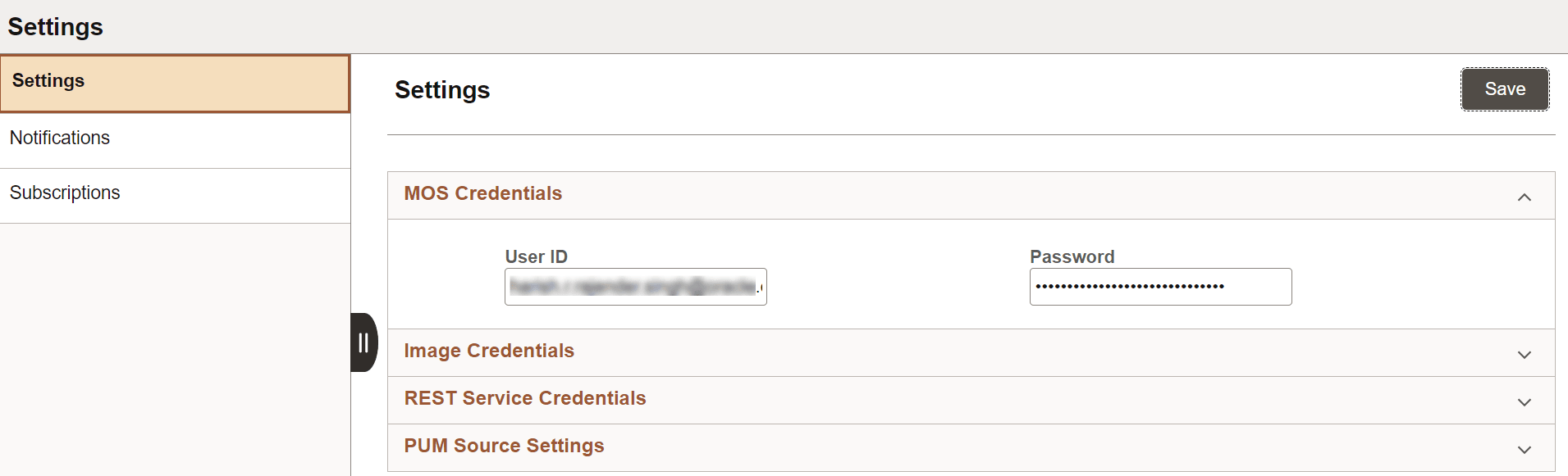

Use the Settings page to review and enter credentials.
This example illustrates the fields and controls on the Settings page for MOS Credentials. You can find definitions for the fields and controls later on this page.
MOS Credentials
These MOS credentials are used to connect to MOS, while downloading PRPs from MOS. When the page is saved, the system will validate connectivity to MOS using the credentials, encrypt the credentials and save to the database.

User ID
Enter the user ID for your My Oracle Support account.
Password
Enter the password for your My Oracle Support account.

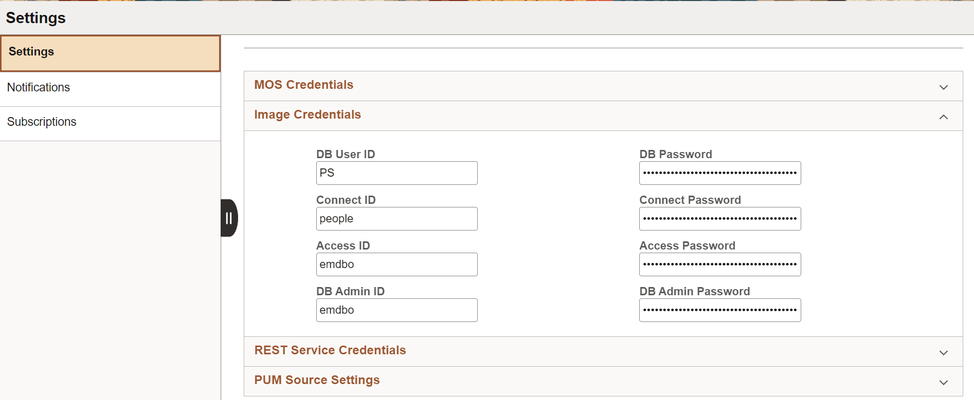

This example illustrates the fields and controls on the Image Credentials section. You can find definitions for the fields and controls later on this page.
Image Credentials
Initially these credentials are provided from the DPK when the PUM environment is deployed, then through the Automated Configuration Manager (ACM).
These credentials need to be updated if they are changed in the PUM source. All credentials are encrypted before storing in the database.
Field or Control Description
DB User ID
Database User ID.
DB Password
Database password.
Connect ID
Connect Id for the database.
Connect Password
Connect ID password.
Access ID
Access Id for the database.
Access Password
Access ID password
DB Admin ID
Database Administrator ID.
DB Admin Password
Database Administrator ID password.

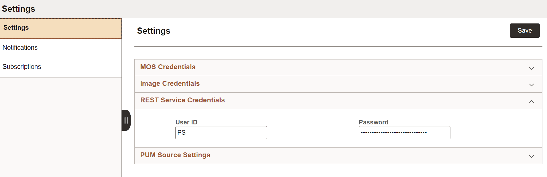

This example illustrates the fields and controls on the REST Service Credentials. You can find definitions for the fields and controls later on this page.
These credentials need to be updated if the REST Service credentials are changed in the PUM source.
REST Services are used by the Download Manager that downloads PRPs to communicate status of downloads. The user ID must have permission list PTPT4300.

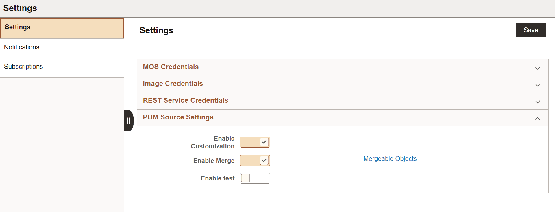

This example illustrates the fields and controls on the PUM Source Settings. You can find definitions for the fields and controls later on this page.
PUM Source Settings- PAU
Use the PUM Source Settings to enable the upload of customization projects and enable object merge.
Enable Customization
Enables the upload of customizations to the PUM Source.
Note that you can set up customization repository from Change Assistant as well.
See Understanding Customization Repository
Enable Merge
Enables object merge for PeopleCode, SQL and XSLT objects in your Customization Repository.
When object merge is enabled in the PUM source, the upload Customization fetches the object merge data in the Customization project (Peoplecode, SQL and XSLT) and schedules version update Application Engine to set the appropriate object version to the mergable objects uploaded.
Note that you can enable object merge from Change Assistant as well.
See Understanding PUM Automated Merge
Enable test
Enables the upload to test repository.
Mergeable Objects
Shows a list of mergeable objects.
