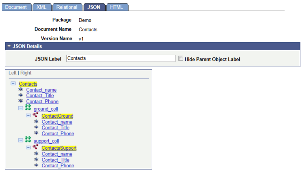

Define Root Labels for JSON Documents
When you create a JSON document, by default the system uses the root element label from the logical document as the JSON root label. You can use the default root label or define a different root label for the JSON document.
Use the Document Builder – JSON page to define a root element label for a JSON document. To access the page, select and click the JSON tab.
This example illustrates the Document Builder – JSON page. Use the JSON Details section to define a JSON root label.
To define a root label for a JSON document:
Access the Document Builder – JSON page ( and click the JSON tab).
In the JSON Details section, click the arrow icon to expand the section.
In the JSON Label field enter a label for the JSON document.
Click the Save button.
Note that if the JSON Label field is left blank, the system will default the field value to the root label of the logical document when you save the document.

Omitting the JSON Label in Generated JSON
Use the Hide Parent Object Label box in the JSON Details section of the Document Builder – JSON page to omit the JSON label (object name of the parent document) in the generated JSON output.
Doing so provides more flexibility in creating third–party JSON strings.
The Hide Parent Object Label box is enabled only when a document is created using the Integration Broker Consume Web Service wizard.
If the check box is not selected the JSON string to parse must have the parent JSON label present in the string and in the correct format.
The following examples show generated JSON for a document when the Hide Parent Object Label option is not used and when it is used.
