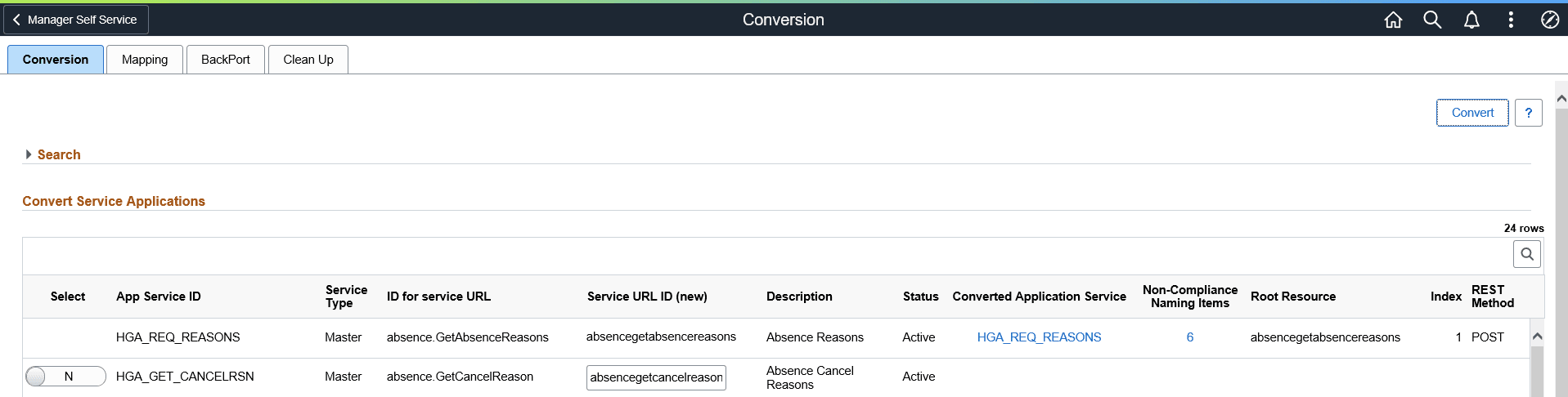

This example illustrates the fields and controls on the Chatbot Conversion page. You can find definitions for the fields and controls later on this page.
Field or Control Description
Select
Select Y to convert the application service. For Application Services that have already been converted, the selection option will be disabled.
App Service ID
Existing chatbot service that requires conversion.
Service Type
Displays service type.
ID for Service URL
Existing ID for service URL that needs to be converted.
Service URL ID (new)
Displays the new Service ID URL. The administrator can optionally update the value in the Service URL ID edit box.
Description
Description of the existing application service.
Status
Status of the exiting application service.
Converted Application Service
Displays the name of the converted Application Service.
Click this link to view or edit the Application Service.
Non-Compliant Naming Items
Indicates the number of non-compliant items after conversion. Select this link to display the non-compliant naming values such as Root Resource Name, Input/ Output parameters, URI Template, and no JSON description (schema) for types of Compound, Compound Array and Custom.
Root Resource
Displays the name of the new root resource after conversion.
Index
Displays URI Index used for the converted application service.
REST Method
Displays the REST method created for the converted application service.
