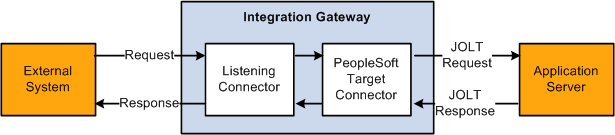

This section describes the flow of a typical inbound request from an external system through PeopleSoft Integration Broker.
This example illustrates the flow of an outbound request through PeopleSoft Integration Broker.
Flow of an inbound request through PeopleSoft Integration Broker
After the incoming request has been received by the integration gateway, the flow through PeopleSoft Integration Broker is the same, regardless of the listening connector used. With this in mind, no specific listening connector will be discussed here. The scenario is simple: a request is sent into the gateway, which then passes it on to the application server. The application server processes the request, and returns a response.
