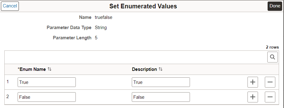

Adding Enumerated Values
Enumerated Values can be added to parameter type String or String List. To add enumerated values:
  1. Create the String or String List and select Done.
  2. Open the parameter, it will contain a link to Add Enumerated Values.
  3. Select the Add Enumerated Values link.
    This example illustrates the fields and controls on the Set Enumerated Values page.
  4. Enter the values and click Done.
