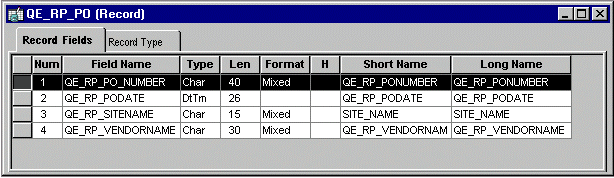

This image is an example of input record for BulkExecute. Here are two PeopleSoft records that could be used as input and output records for BulkExecute. The key fields in the input record, which need to have the BulkExecute ID check box checked in Application Designer, are QE_RP_PO_NUMBER and QE_RP_SITENAME. These key fields are used both for input and output.
Example input record for BulkExecute

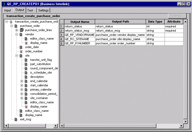

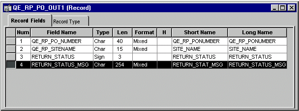

This image is an example of output record for BulkExecute.
Example output record for BulkExecute

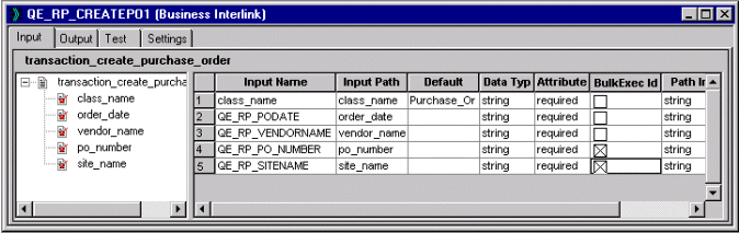

The following is an example of Business Interlink inputs for BulkExecute. Here are the corresponding inputs and outputs for a Business Interlink that has had its inputs and outputs renamed to match the field names in the records. The inputs and outputs have been renamed where necessary to match the record field names.
Example Business Interlink inputs for BulkExecute
The following image is an example of Business Interlink inputs for BulkExecute.
