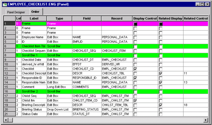

The following an image of EMPLOYEE_CHECKLIST Page order. The example uses the rowset on level one from the EMPLOYEE_CHECKLIST page. A PeopleCode program running in a field on level zero in that page can access the level one (child rowset).
EMPL_CHECKLIST is the primary database record for the level one scrollbar on the EMPLOYEE_CHECKLIST page. The following PeopleCode accesses the level one rowset using EMPL_CHECKLIST. The Business Interlink object name is QE_BI_EMPL_CHECKLIST. This Business Interlink object uses the level one rowset as its input and its output.
The InputRowset method uses this rowset as input for QE_BI_EMPL_CHECKLIST. Then a blank duplicate of the rowset is created with CreateRowset, and then the output of QE_BI_EMPL_CHECKLIST is fetched into the blank rowset with FetchIntoRowset.
