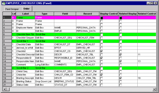

The example uses the rowset on level one from the EMPLOYEE_CHECKLIST page. A PeopleCode program running in a field on level zero in that panel can access the child rowset (level one), shown below from Scroll Bar 1 to Scroll Bar 2.
EMPLOYEE_CHECKLIST Page structure
EMPL_CHECKLIST is the primary database record for the level one scrollbar on the EMPLOYEE_CHECKLIST page. The following PeopleCode access the level one rowset using EMPL_CHECKLIST. The Business Interlink object name is QE_BI_EMPL_CHECKLIST. This Business Interlink object uses the level one rowset as its input and its output.
