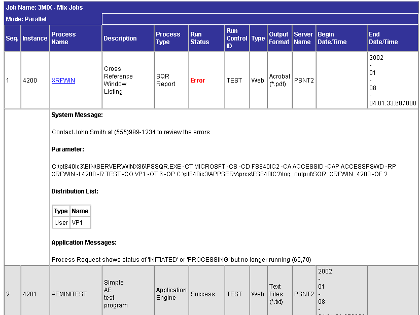

The following screen image is an example of a HTML report created after executing the above mentioned PeopleCode program:
Example HTML report
