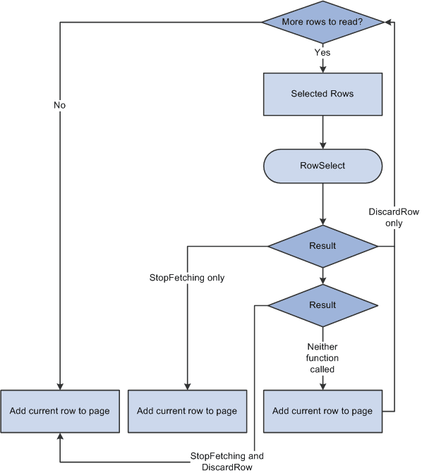

    In RowSelect PeopleCode, you can refer only to record fields on the record that is currently being processed, because the buffers are in the process of being populated. This means that the data might not be present.
The following flowchart shows the logic of RowSelect processing in a Page.
RowSelect processing logic
