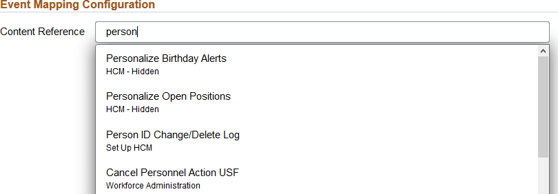

Searching for a Content Reference
Event mapping is restricted to content references for registered components only. Therefore, search results are filtered to include registered components only.
After clicking the Add Configuration button, enter a search term or phrase. The search results are updated as you type. Select a content reference from the search results to add a new event mapping configuration.
Searching on the Event Mapping Configuration page

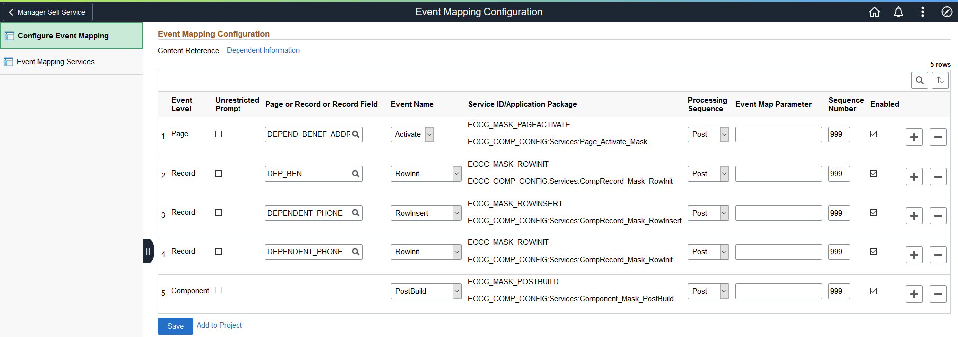

This example illustrates the fields and controls on the Event Mapping Configuration page. You can find definitions for the fields and controls later on this page.
Field or Control Description
Event Level
Select an option to specify the event level:
  • Component
  • Page
  • Rec Field
  • Record
Unrestricted Prompt
Select the unrestricted prompt only when the item for which you are searching is not found on a page definition that is explicitly included in the component definition. This allows an unrestricted search of all matching definitions within the system.
Use the unrestricted prompt only when:
  • Searching for secondary pages invoked by the main page or by a subpage at any level within the component.
  • Searching for records, derived/work records, or record fields defined on any subpage or secondary page at any level within the component.
Note: If you return to this configuration, the unrestricted prompt check box is no longer selected. However, the actual configurations are retained. This allows you select the unrestricted prompt again if you need to reconfigure these items in an unrestricted manner.
Page or Record or Record Field
Select the page name, record name, or combination of record name and field name corresponding to the event level selected previously. If Component is selected as the event level, this field is not displayed and no selection is required.
Event Name
  • At the component level, an application class-based service can be associated with one of the following PeopleCode events:
    • PostBuild
    • PreBuild
    • SavePostChange
    • SavePreChange
    • Workflow
  • At the page level, an application class-based service can be associated with the Activate event only.
  • At the component record level, an application class-based service can be associated with one of the following PeopleCode events:
    • RowDelete
    • RowInit
    • RowInsert
    • RowSelect
    • SaveEdit
    • SavePostChange
    • SavePreChange
    • SearchInit
    • SearchSave
  • At the component record field level, an application class-based service can be associated with one of the following PeopleCode events:
    • FieldChange
    • FieldDefault
    • FieldEdit
    • SearchInit
    • SearchSave
Service ID/Application Package
Select an application class-based related content service definition.
Note: The list of application class-based services is filtered to include only those that have implemented the PT_RCF:ServiceInterface base class.
Processing Sequence
Select the processing sequence with respect to any PeopleCode program defined for the same event on the component definition:
  • Override – Select to override any PeopleCode program defined for the same event on the component definition.
  • Post – Select to execute the mapped application class after any PeopleCode program defined for the same event on the component definition.
  • Pre – Select to execute the mapped application class before any PeopleCode program defined for the same event on the component definition.
Event Map Parameter
Optionally, specify a string value to selectively invoke a specific block of code within the application class. This allows you to use a single application class in multiple configurations separating each bit of functionality into separate blocks.
This application class must implement the eve_execute method in addition to an empty execute method. Within the eve_execute body, conditional logic must evaluate the event map parameter and execute the appropriate block of code for each valid parameter value.
See the following PeopleCode example.
Sequence Number
Specify a processing sequence when more than one custom application class program is mapped to the same event.
Enable
Deselect this check box to disable execution of the application class, but retain the event mapping configuration.
Save
Click the Save button to save the configuration.
Add to Project
Click the Add to Project link to access the Add To Project page to insert this event mapping configuration into an ADS project. See Lifecycle Management Guide: Adding Data Set Instances from Object Designer Pages for more information.
