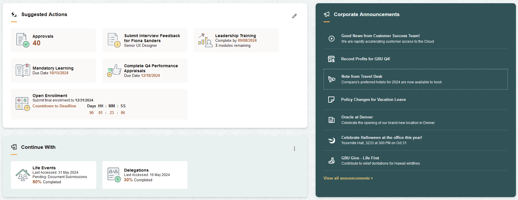

The following example shows some of the visual forms of sections.
This example illustrates some of the visual forms of sections.
Visual forms of sections
