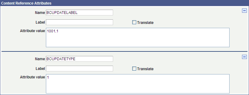

Define the content reference attributes on the content reference that is being navigated to. You can specify one or both of the following attributes:
  • Use the BCUPDATELABEL attribute to specify a message set and number that defines the label to be displayed in the breadcrumbs.
  • Use the BCUPDATETYPE attribute to specify a numeric value that indicates:
    • 0 – Do not update the breadcrumbs.
    • 1 – Replace the last item in the breadcrumbs with the new element.
    • 2 – Preserve the existing breadcrumbs and append the WorkCenter page that is the target to the existing list.
    • 3 – Append hidden items to the breadcrumb list.
To modify the breadcrumb behavior for a content reference:
  1. Go to PeopleTools, and then Portal, and then Structure and Content.
  2. Navigate the menu folder hierarchy to the content reference that you want to modify.
  3. Click the Edit link for the content reference.
  4. In the Content Reference Attributes group box, add an attribute for each aspect that you want to specify (BCUPDATELABEL, BCUPDATETYPE, or both).
  5. For each attribute, deselect the Translate option.
  6. Save the content reference definition.
The following example shows both the BCUPDATELABEL attribute and the BCUPDATETYPE attribute defined for a content reference:
BCUPDATELABEL and BCUPDATETYPE content reference attributes
