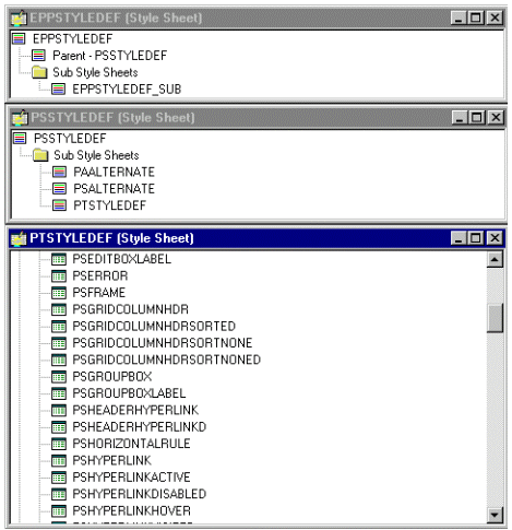

Two ways are available by which you can see the style classes defined in a style sheet.
If you access PeopleSoft Application Designer, you can open the designated style sheet and view its definitions in a graphical interface.
Style sheet definitions

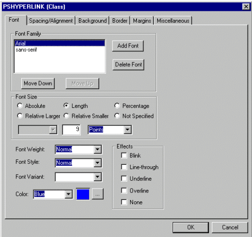

Double-click any style class to view and modify its definition.
Style class dialog box - Font tab
