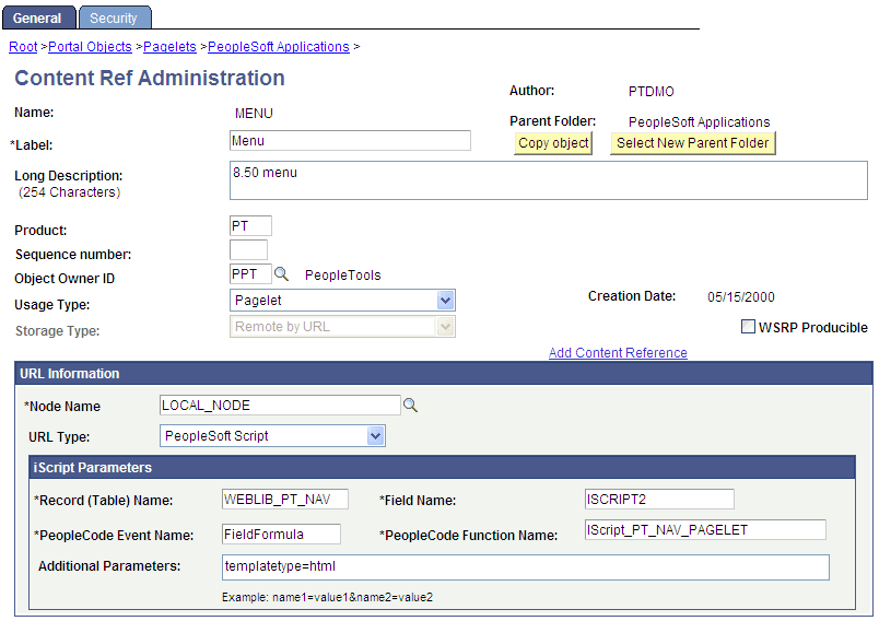

To reconfigure the Menu navigation pagelet:
  1. Select PeopleTools, and then Portal, and then Structure and Content.
  2. In the Folders group box, click Portal Objects, and then click Pagelets.
  3. Click the PeopleSoft Applications link, and then click the Edit link for the Menu.
  4. In the Field Name field, delete the existing value and enter ISCRIPT2.
  5. Save the component.
    The content reference will look like this:
    After completing the preceding reconfiguration steps, the Menu navigation pagelet will appear similar to the following:
    Menu pagelet after reconfiguration

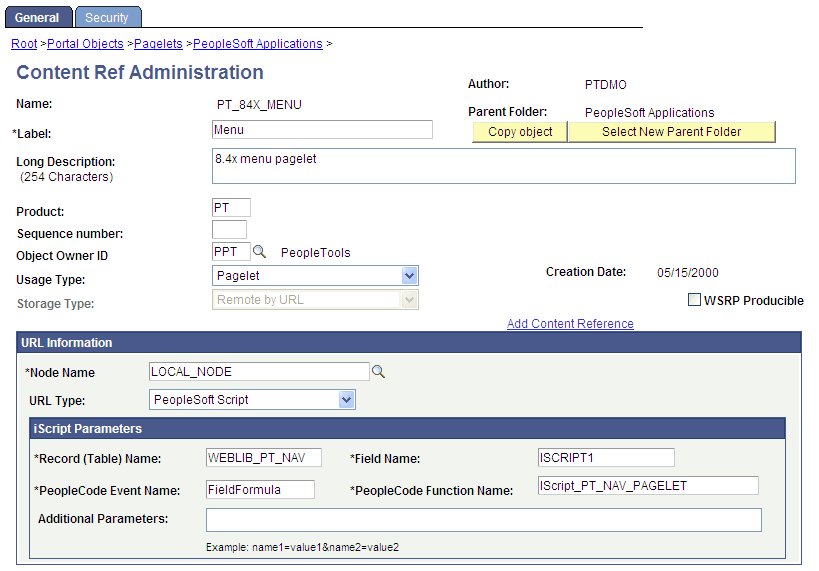

  6. In the breadcrumbs, click the PeopleSoft Applications link.
  7. Click the Edit link for Menu - Classic.
  8. In the Label field, replace Menu - Classic with Menu.
  9. In the Field Name field, replace ISCRIPT2 with ISCRIPT1.
  10. Save the component.
    After completing the preceding reconfiguration steps, the Menu - Classic navigation pagelet will appear similar to the following:
    Menu - Classic pagelet after reconfiguration
  11. Stop and restart the application and web servers.
