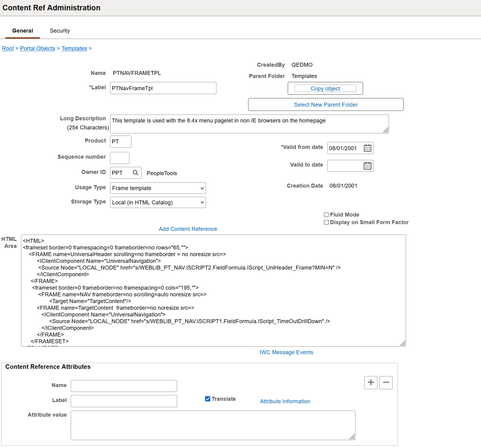

This example illustrates a content reference definition for a frame-based static template.
Content reference for a frame-based static template
The Content Ref Administration page shows how the HTML exists within the context of the whole content reference. Note that the usage type is set to Frame template. In the previous example of a page-based template, which uses HTML tables, the usage type would have been set to HTML template.
