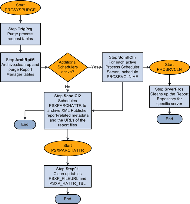

The PRCSYSPURGE application engine program is run on the master Process Schedule server. The following steps are executed by the program:
  1. Step TrigPrg: This step updates statistics and purges process request tables.
  2. Step ArchRptM: This step cleans up Report Manager Repository and purges Report Repository tables.
  3. If more than one Process Scheduler server exists, the application engine program PRCSRVCLN is scheduled to run. This program cleans up the Report Repository for a specific server.
  4. Step SchdlCl2: This step schedules the application engine program PSXPARCHATTR to run. This program archives BI Publisher report-related metadata and the URLs of the report files.
This diagram shows the flow for the PRCSYSPURGE application engine program
Program flow for PRCSYSPURGE application engine program
