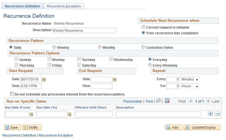

To access the Recurrence Definition page, select PeopleTools, and then Process Scheduler, and then Process Scheduler Recurrences, and then Recurrence Definition.
This example illustrates the fields and controls on the Recurrence Definition page. You can find definitions for the fields and controls later on this page.
Field or Control Description
Recurrence Name
This value appears in process and job definitions, so it should be readily identifiable.
Description
Enter a description for this recurrence definition. The default is the recurrence name.
Schedule Next Recurrence when
Current request is initiated and Prior recurrence has completed
Specify when the next recurrence should start.
Note: When Prior recurrence has completed is selected, the definition is set to recur on success of the last instance. When the last instance runs to Warning, the scheduler treats the instance the same as Success.
Recurrence Pattern
The contents of this group box change, depending on the recurrence pattern that you select.
When validating the next recurrence date on which a recurrence definition is set to run multiple times in a day, the system determines whether the calculated time for the day exceeds the maximum recurrence period for that day. For example, the definition is set up to run every hour for eight hours, beginning at 8:00 a.m. You select the definition for a process at 5:00 p.m. Due to the lateness of the day, the process cannot run every hour, eight times, so the process does not run until 8:00 a.m. the following day.
Daily
When you select this option, also select either Everyday or Every Weekday. The system automatically selects check boxes for the days Sunday through Saturday (every day) or Monday through Friday (every weekday). The check boxes are not available for entry to prevent changes.
Weekly
Select check boxes for the days on which the process should run. For example, every Friday or every Monday, Wednesday, and Friday.
Monthly
When you select this option, also select either Day of Month to enter a numeric date or The to enter a day of the month.
For example, select Day of Month and enter 15 to define the process to run on the 15th day of every month. Enter 31 to have the process run on the last day of every month. The system automatically adjusts for the varying number of days in each month.
Note: Typically, the value for the Day of Month field should match that of the Start Request Date field. For example, if you select August 27, 2004 as the start request date, you must ensure that the value for the Day of Month field is 27 to define the process to run on the 27th day of every month. Otherwise, more than one recurrence run may occur.
If you select The, select either 1st, 2nd, 3rd, 4th, or Last. Then select a specific day. For example, select 1st and Thursday to have the process run on the first Thursday of every month.
Customized Dates
Use this option when processes must run automatically on:
  • A schedule that is not daily, weekly, or monthly (for example, quarterly).
  • Specific dates.
When you select this option, add the specific run dates in the Run on Specific Dates group box.
Start Request
Date and Time
Enter the effective date and time at which the recurrence definition should become active.
Do not schedule any processes missed from the recurrence pattern
Select to run recurring process only at the times specified. Leave blank to run recurring process in catch up mode.
Note: This option is used in situations such as when processes have been scheduled after the runtime, or when servers are down when the processes should have run.
Example 1: A process is scheduled to run daily at 10:00 a.m. but the recurrence is not set up until 2:00 p.m. If this option is selected, the process will not run until 10:00 a.m. the following day. If this option is not selected, the process will run immediately to catch up for the missed 10:00 a.m. run.
Example 2: A process is scheduled to run hourly every day from 9:00 a.m.– 3:00 p.m. The process runs successfully at 9:00 a.m., and then the server goes down. It is not recovered until 5:00 p.m. If this option is selected, the process will not run again until 9:00 a.m. the following day. If this option is not selected, the process will run six times to catch up for the missed runs scheduled for 10:00 a.m., 11:00 a.m., 12 noon, 1:00 p.m., 2:00 p.m., and 3:00 p.m.
End Request
Date and Time
Enter the date and time at which the recurrence definition should become inactive. Leave blank to keep the recurrence definition active indefinitely.
Repeat
Every and For
Indicate how many times the process repeats. For example, you might specify that the process runs every 10 minutes for an hour.
Use this group box when the recurrence pattern is Customized Dates.
Run Date (From)
Select the date on which you want this process to run.
Run Date (To)
To run the process every day for a specific period, select the last date of the period. Leave blank if the process is to run for only one day.
Effective Until (Year)
To end the schedule after a specific number of years, enter the four-digit year. Leave blank for the schedule to continue indefinitely.
