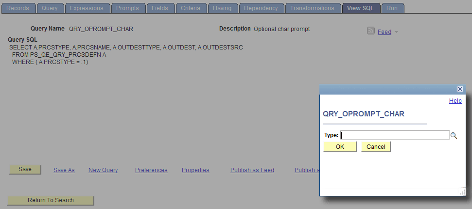

When you use the Run page in Query Manager to run a query with the prompt set to Optional, a prompt window is displayed.
This example shows the prompt window when you run a query using the Run page in Query Manager.
View SQL page, prompt window with optional prompt
Because the prompt is set to optional, you can either enter a valid prompt value or click the OK button on the prompt window without entering a prompt value.

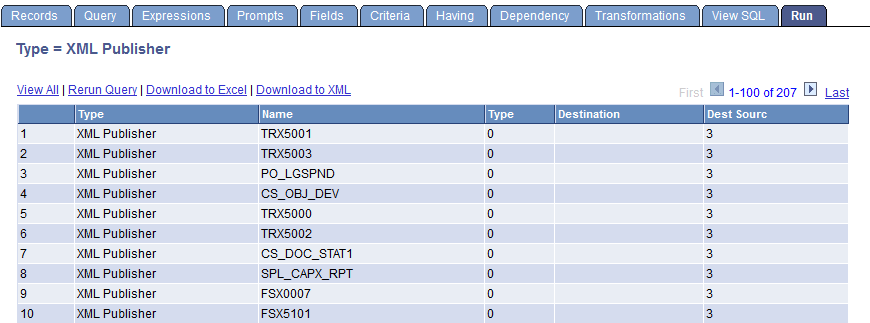

  • If you enter a prompt value, that prompt value must validated because the prompt is defined to have the Edit Type option set to Prompt Table. If so, the query is run using the entered prompt value and the report results display the prompt setting.
    This example shows the query results with Type = XML Publisher is displayed as the prompt setting:

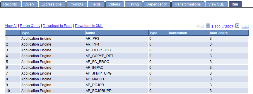

  • If you click the OK button without entering a prompt value, the criteria defined to compare with the optional prompt is dropped during runtime. The query is run without the prompt value and the report results do not display the prompt setting.
    This example shows the query results without the prompt setting.
