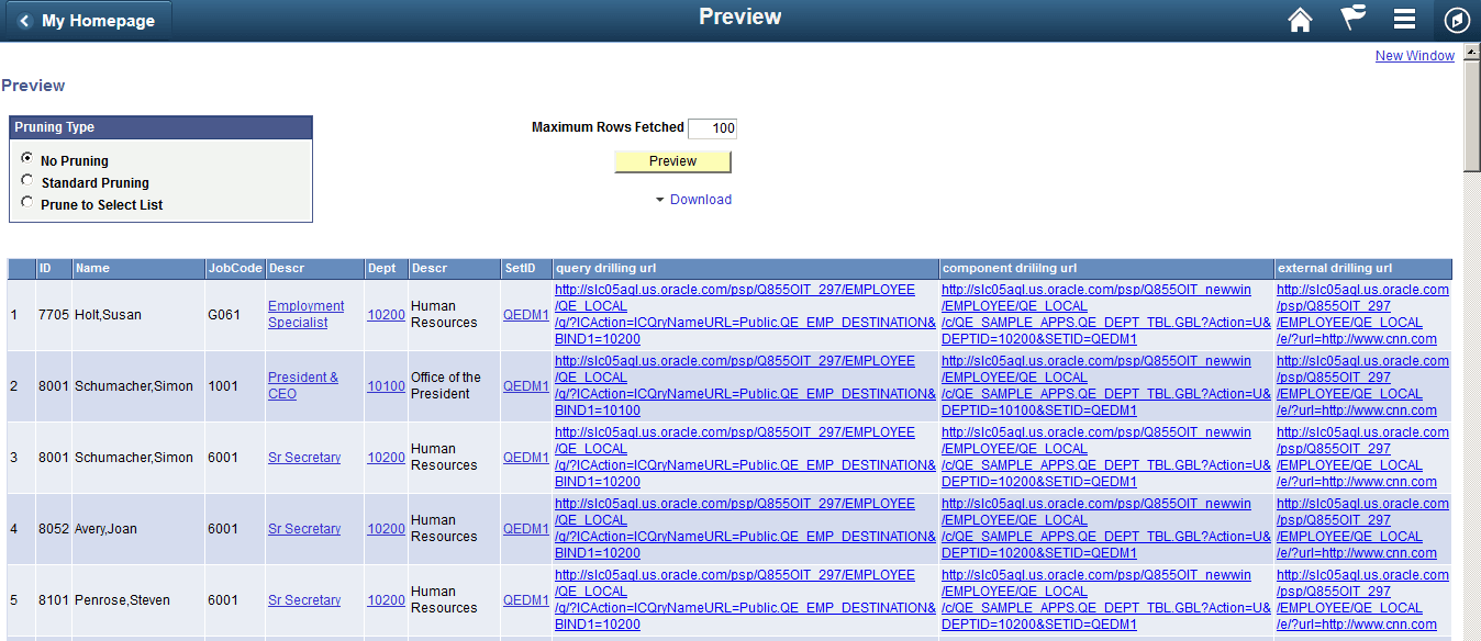

This example illustrates the fields and controls on the composite query Preview page. The Pruning Type is set to No Pruning.
Composite Query Preview page

Pruning Type
Based on the attributes that are selected in the result sets and the attribute dependency, Composite Query might be able to simplify the SQL statements that are generated for the underlying queries. The pruning process removes the tables in the FROM clause if the pruning rules allow. It also removes the columns in the SELECT clause, which corresponds to the view row attributes that users have not selected.
The available pruning types are:
  • No Pruning
    Selecting this option enables the system to produce a full SQL statement without any pruning.
    By default, the Pruning Type is set to No Pruning.
  • Standard Pruning
    Selecting this option enables the system to prune only a field or a table when the pruning process does not change the result set. The result sets of the SQL statements that are generated by the Standard Pruning and No Pruning options are identical. The field is not pruned if it is used in the query, such as the JOIN criteria in the FROM, WHERE, GROUP BY, or ORDER BY clauses.
    Note: In general, standard pruning does not prune much except the Cartesian Join, where a table does not have any relationship with other tables.
  • Prune to Select List
    Selecting this option enables the system to remove all join criteria and joined table from the SQL if the fields from that table is not selected. The system can prune a table from the query if no field in the table is selected for the composite query. This pruning option can change the result set because the table that is being pruned can have been used to filter the result set based on the JOIN it has against the other tables.
    You should select the Prune to Select List option when the result set is not altered. To accomplish that, you should ensure the join produces only extra columns and nothing more. The implication is that the relationship between the joined tables is many-to-one or one-to-one.
Note: The Standard Pruning and Prune to Select List options enable the system to prune a field from the SELECT clause if it is not used by the composite query. The dependency settings of the base queries in the Query Manager – Dependency tab are also used to determine whether a field or a table can be pruned. See Defining Record and Field Dependencies.
Maximum Rows Fetched
Use to specify the maximum number of rows returned.
By default, the value in the Maximum Rows Fetched field is set to 100.
Preview
Click this button to refresh the results using the new settings in the composite query Preview page.
If the composite query has prompts, a prompt window appears after you click the Preview button.
Download
Click to select an option to download the composite query results to either an HTML file or an XML file.
