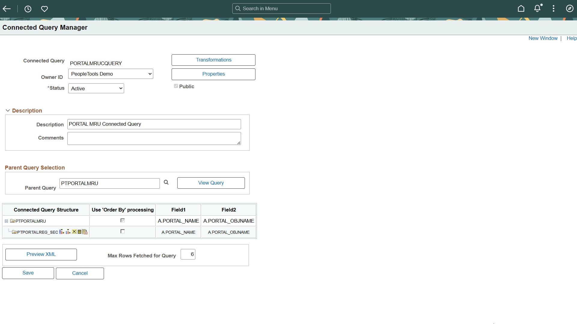

Setting the SupportsOrderBy Property
To set the SupportsOrderBy property:
  1. Select Reporting Tools, Connected Query, Connected Query Manager.
  2. Open an existing query and click the Properties button.
  3. Select the True option from the Property Value list for the SupportsOrderBy property.
  4. Click the OK button to return to the Connected Query Manager page.
    The Use 'Order By' processing column is available in the Connected Query Structure section.
    Connected Query Manager page - Use Order By processing column
    In this example, the Use ‘Order By’ processing option for the first query PSMENUDEFN is always selected and you cannot modify it. The Use ‘Order By’ processing options for the following queries become active when you click the query name in the Connected Query Structure column.
    If you reopen the Connected Query Property page and set the SupportsOrderBy property to False, then the Use ‘Order By’ processing column is not available in the Connected Query Manager page. If you later set the SupportsOrderBy property back to True, the system will display the processing option that you previously selected.
    The OrderBy processing option is not applied if the connected query is running in the Preview XML mode.
  5. Select the appropriate options in the Use ‘Order By’ processing column.
    If the Use ‘Order By’ processing option is selected for a specific query (for example, PSMENUITEM), then:
    • The parent query (in this example, PSMENUDEFN) SQL will be modified by adding the ORDER BY clause. Data returned from the parent query will be ordered using a set of related fields defined to link a child query to its parent. In this example, it is the field A.MENUNAME.
    • If the parent query (PSMENUDEFN) has an existing ORDER BY clause defined inside the query definition, it will be removed and replaced with the ORDER BY clause being generated by the processor.
    • A single SELECT statement based on a query definition will be issued for a child query (PSMENUITEM) with NO FILTERING based on related field values received for a parent query.
    • Output XML data will be written row by row for a child query with a reference to the data that is returned from related fields used for a parent query.
  6. Click the Save button.
