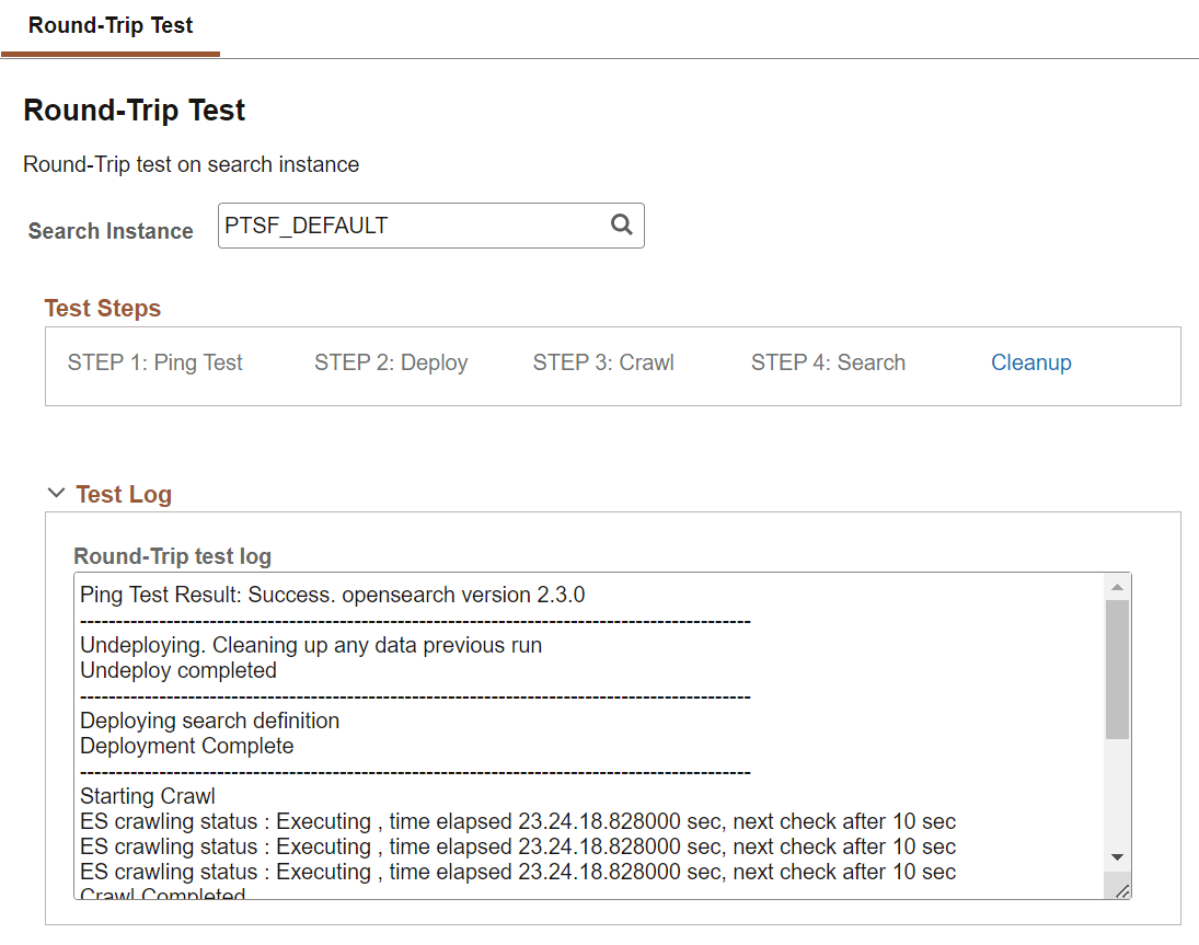

Access the Round-Trip Test page by selecting PeopleTools, and then Search Framework, and then Search Admin Activity Guide, under Testing and Utilities, then select Round-Trip Test.
The round-trip test performs a set of diagnostic steps using a test search definition, delivered with PeopleTools named RNTRPTST. It provides end-to-end diagnostic tests to verify and troubleshoot the PeopleSoft and search engine integration.
This example illustrates the fields and controls on the Round-Trip Test page. You can find definitions for the fields and controls later on this page.

Search Instance
Select the appropriate search instance defined for this PeopleSoft system.
Test Steps
The Test Steps grid contains a series of links that are ordered in a typical troubleshooting sequence. Only one link is active at a time, and each link becomes active only after the previous step has completed successfully.
  1. Ping Test: Runs a ping test against the search engine server instance defined for your system.
  2. Deploy: Deploys the RNTRPTST search definition and associated category to the search engine.
  3. Crawl: Runs a test crawl using the RNTRPTST definition.
  4. Search: Runs a sample search based on the index populated by the RNTRPTST search definition.
  5. Cleanup: Click to remove the deployment of the RNTRPTST search definition and run any related cleanup tasks.
Test Log
Indicates whether the system successfully created the feed output, required to populate the index.
