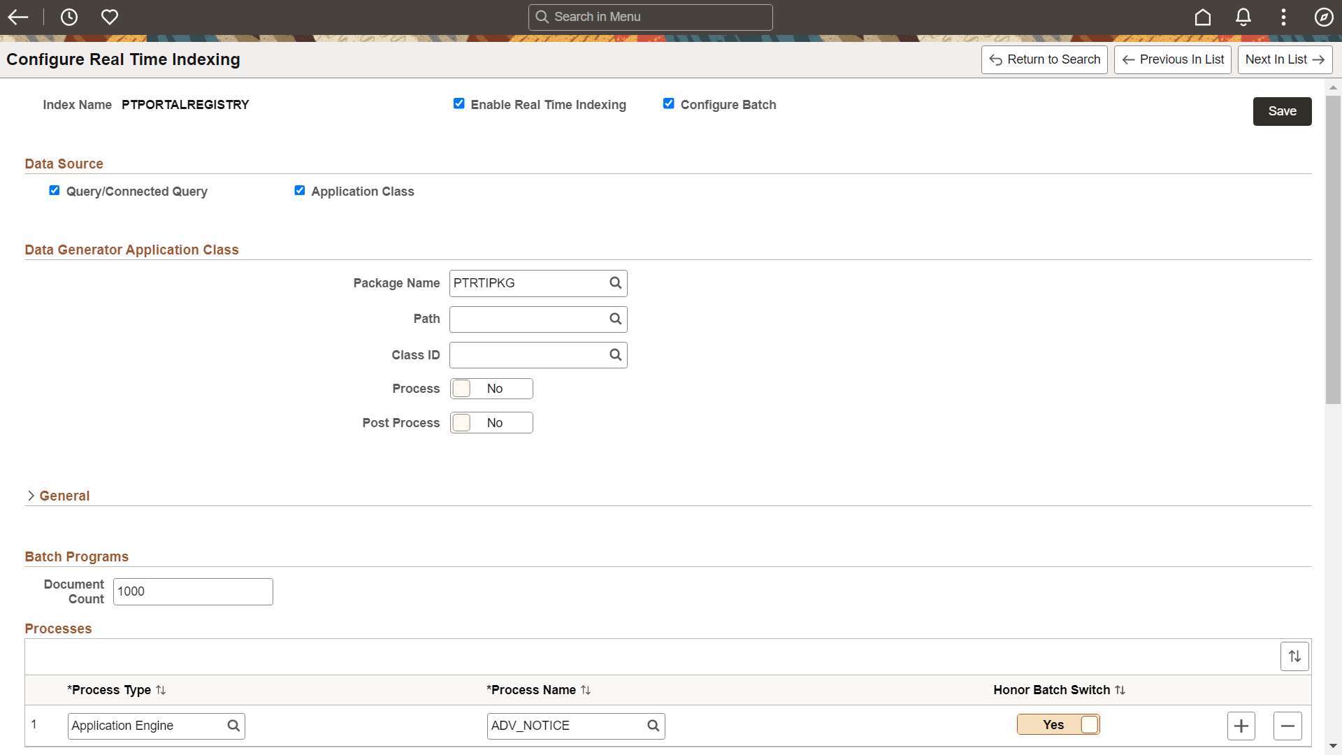

This example illustrates the fields and controls on the Configure Real Time Indexing page with the Configure Batch option selected:
Configure Real Time Indexing page with Configure Batch option
Field or Control Description
Document Count
The document count is a threshold beyond which the real-time indexing process should be disabled during batch runs. Large batch jobs with records beyond this count should have real-time indexing disabled.
The default is set to 0. 0 means real-time indexing is not turned off.
Note: This count will be used by application developers as a deciding factor to invoke the TurnOffRTI function. Applications will look for a number greater than 0 to compare to the record count for batch jobs to determine whether or not to disable real-time indexing.
Process Type
Select the process type.
Process Name
Select the process name.
Honor Batch Switch
Set the Honor Batch Switch option to Yes if you want the Real Time Indexing Switch to honor the process (batch program). When the Honor Batch Switch option is set to No, the request to turn off real-time indexing for the batch program will be ignored.
Note: Applications will deliver the configuration with the Honor Batch Switch turned off. You must turn it to Yes if you have large batch runs and you must also set the Document Count.

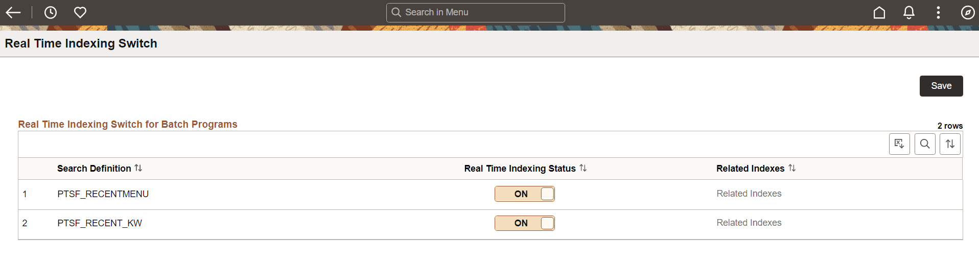

Using the Real Time Indexing Switch Page
The Real Time indexing Switch page displays the current real-time indexing status of the listed search definitions. Administrators can use this page to check the real-time indexing status and turn it on or off only in scenarios where real-time indexing was not automatically turned on or off. Oracle recommends that administrators exercise caution before turning real-time indexing on or off on this page.
This example illustrates the fields and controls on the Real Time Indexing Switch page:
Search Definition
Displays the search definition’s name.
Real Time indexing Status
Displays the real-time indexing status of the listed search definitions. Administrators can check the status and turn it on or off only in scenarios where real-time indexing was not automatically turned on or off.
Related Indexes
Select the Related Indexes link to see all the related search definitions that share a common trigger record or template (In the case of Activity Guide search definition).
