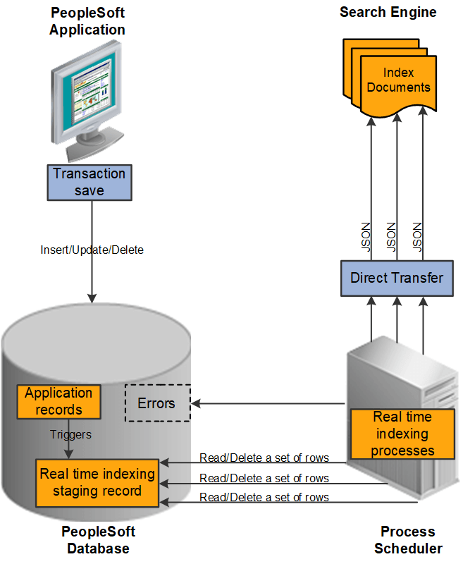

Search Framework implements set based processing in real-time indexing as shown in the following diagram.
The following diagram illustrates the process flow of the real-time indexing process.
Real time indexing process flow
Real-time indexing uses database triggers as the initializing point for the communication to the search server. As the data is inserted, updated, or deleted, the database trigger associated with the application record inserts a row in the real-time indexing staging table. The staging table acts as an interim data holder by storing the keys of the transaction.
When batch processing is enabled for a search definition, updated data is not pushed to the real-time indexing staging table for the search definition. For more information, see Turning Off Real-Time Indexing During Batch Processing.
A dedicated Process Scheduler process for real-time indexing polls the staging table at regular intervals for any data to process. You can configure the number of processes in the Process Scheduler configuration properties file. By default, only one process is initiated. You may scale up the number of processes by changing the maximum number of instances.
Real-time indexing processes the transactions stored in the staging table as a set. The size of the set is a configurable parameter in the Search Options page, which can be specified as per the available resources in the Process Scheduler server. A set can contain just one transaction or it can contain the maximum number of transactions as specified in the Real Time Indexing Set Size property based on the available data at any point in time.
Real-time indexing again processes each set for a specific search definition and begins the data retrieval process for each search definition. After the data is collected and formatted to a JSON structure, it is transferred to the search server using Direct Transfer.
When an application batch program updates a large volume of data in an insert or update action, you can expect delay in updating the data to the search server due to the relatively large volume of data as compared to the online transactions with low volume. Therefore, PeopleSoft recommends that you use the real-time indexing batch switch for search definitions with batch programs having large volume indexing.
In most of the search definitions enabled for real-time indexing, you may not need to schedule incremental indexing. However, indexes that have data with effective date changes may require the incremental indexing schedules for the actual data synchronization to take place. A change on the effective dated rows does not initiate a trigger, therefore such search definitions should be indexed using the existing indexing methods. While real-time indexing ensures data synchronization based on transaction updates, incremental indexing updates the indexed data (from prior indexing schedules) to the current date.
You should periodically run the AE maintenance program (PTRTI_TRUNC) of real-time indexing to ensure that the real-time indexing staging tables are de-fragmented after running large volume batch update for better performance. For a description of the AE maintenance program, see Using an Application Engine Maintenance Program.

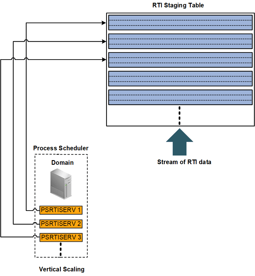

Vertical Scaling
Vertical scaling capability in real-time indexing allows you to effectively process search index data updates during high-volume scenarios.
The following diagram illustrates the process flow of the vertical scaling process.
Vertical Scaling
You can enable vertical scaling processing by vertically “scaling up” the number of RTI server processes within a single process scheduler domain.
Vertical scaling is dependent on the available resources in the system, like memory and CPU. Vertical scaling needs to share the same available resources within the server.

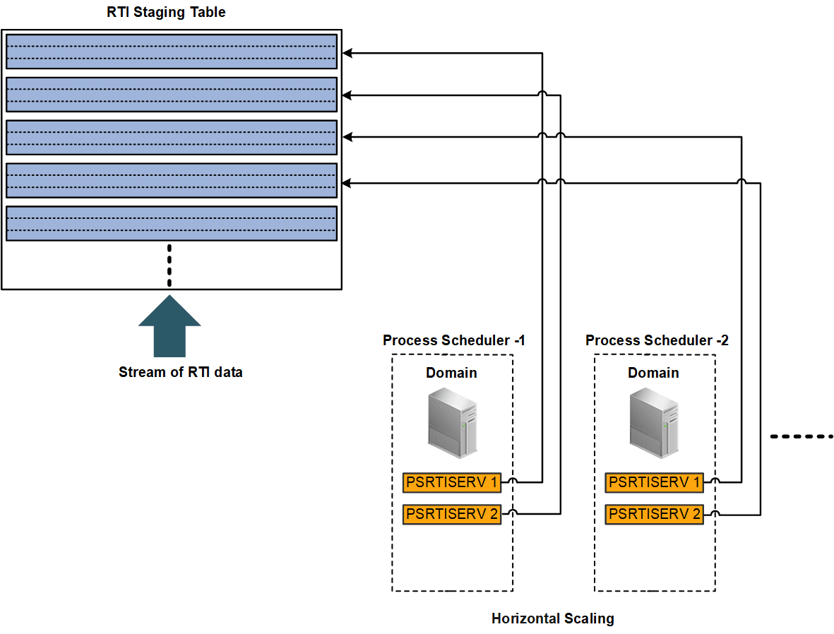

Horizontal Scaling
PeopleSoft Search Framework introduces horizontal scaling for real-time indexing to optimize high-volume data for faster and more efficient processing.
Horizontal scaling enhances parallel processing by adding more domains to an existing configuration and distributing the data and workload among them.
The following diagram illustrates the process flow of the horizontal scaling process.
Horizontal Scaling
You can also enable horizontal processing by horizontally “scaling out” the number of RTI server processes across multiple process scheduler servers.
