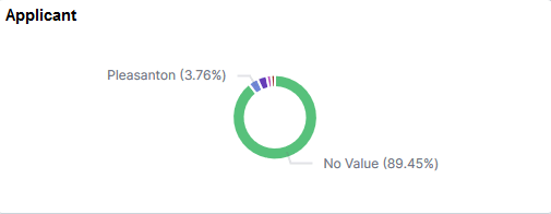

This example illustrates the Applicant dashboard configured as a tile on a homepage.
Dashboard configured as a tile
The tile loads all the visualizations associated with the dashboard, so the rendering of the tile may be delayed based on the data volume and network speed.
