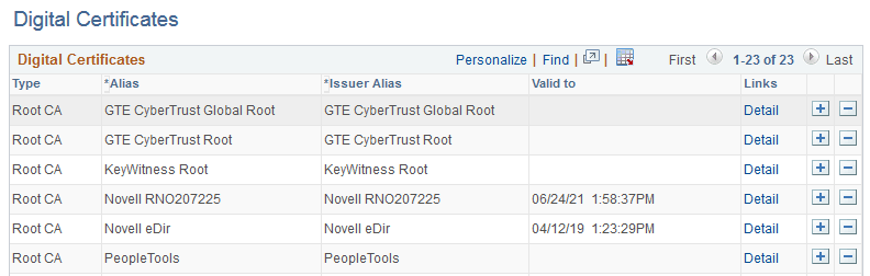

To make the CA certificate available in the Digital Certificate repository of PeopleSoft, add the CA certificate of OpenSearch to PeopleTools, and then Security, and then Security Objects, and then Manage Digital Certificates.
This example illustrates the Digital Certificates page.

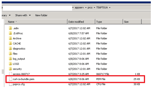

When the process starts, the certificate bundle in PEM format is available in the Process Scheduler server folder.
This example illustrates the certificate bundle in PEM format.
Certificate bundle in PEM format
