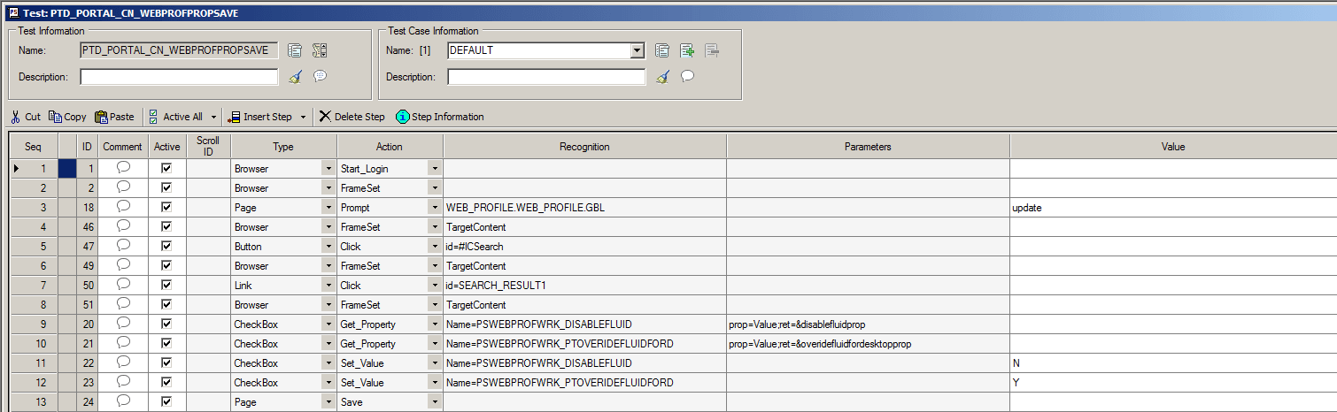

Understanding the PTF Test Structure
A PTF test is composed of a series of steps. This example shows the steps in a simple test.
This example illustrates the fields and controls for a simple PTF test.
Example of a PTF test

In general, a test has a single step for each instruction in a manual test case. For example, consider the following manual test instruction:
12. Enter the value "KU0001" into the text box labeled "Employee ID".
This test instruction could be represented in PTF as a step, as shown in this example:
This example illustrates the step to enter a value in an edit box.
Example of a PTF test step
The PTF test language syntax and vocabulary are designed to read like a technical version of English. As a result, the function of most steps should be apparent from their construction and the context of surrounding steps.
For a detailed reference of PTF step types and actions, see PTF Test Language
