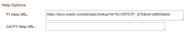

  3. In the Help Options section, enter the F1 URL in the following format:
    https://docs.oracle.com/pls/topic/lookup?id=%CONTEXT_ID%&ctx=library_ID
    Replace the value of library_ID with the library ID that you identified during the Prerequisites.
    Example for the latest PeopleTools 8.57:
    https://docs.oracle.com/pls/topic/lookup?id=%CONTEXT_ID%&ctx=pt882latest
    This example illustrates the PeopleTools Options page with the F1 help URL for the latest PeopleTools 8.62 help:
    F1 Help URL on the PeopleTools Options page
