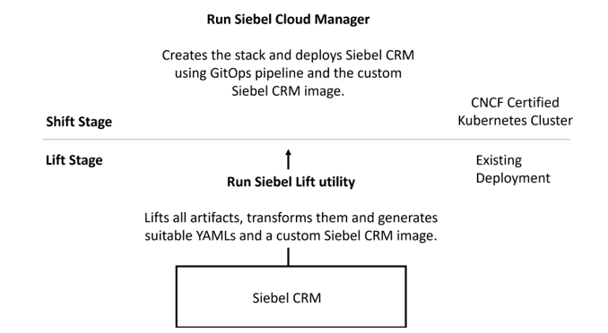

You can migrate an existing Siebel CRM environment to any cloud or a CNCF-certified Kubernetes cluster using SCM in two simple steps:
  1. Lift: In this step, you lift an existing Siebel CRM environment using the Siebel Lift utility that is available on My Oracle Support (MOS) as Siebel CRM 26.8.0.0 Lift Utility (Patch). The Siebel Lift utility:
    1. Builds deployment kits consisting of artifacts derived from your existing deployment of Siebel CRM.
    2. Moves the deployment kits to a storage location such as OCI object storage or an NFS shared directory.
  2. Shift: After the Siebel Lift utility creates and uploads Siebel CRM deployment kits, you specify the deployment parameters in the deployment payload and submit a REST request to SCM to shift your environment. SCM completes the deployment of Siebel CRM according to configurations specified in the deployment payload.
This image explains the steps invoved in migrating an existing Siebel CRM environment.
