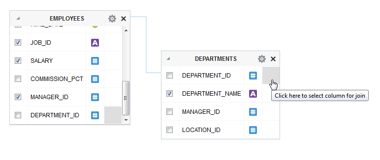

Join Objects Manually
Create a join manually by selecting the Join column in the Design pane.
  1. From the Object Selection pane, select the objects you want to join.
  2. Identify the columns you want to join.
    You create a join by selecting the Join column adjacent to the column name. The Join column displays to the right of the data type. When your cursor is in the appropriate position, the following help tip displays:
    Click here to select column for join
  3. Select the appropriate Join column for the first object.
    When selected, the Join column is darkened. To deselect a Join column, simply select it again or press ESC.
  4. Select the appropriate Join column for the second object.
    When joined, line connects the two columns. An example is shown below.

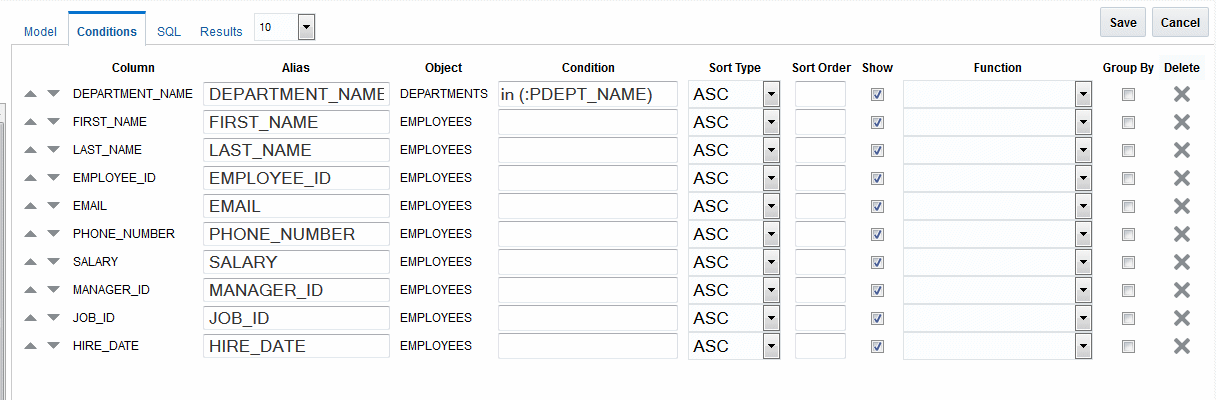

Add a Bind Variable to a Query
After you create a query, you can add a bind variable to the query to pass a parameter to limit the results.
  1. In the Query Builder, click the Conditions tab.
  2. For the column you want to add a bind variable, enter the parameter name in the following format:.
    in (:PARAMETER_NAME)
    After you edit the query, the Query Builder can no longer parse it. You must make any additional edits manually.
For example, in the employee listing, you can choose a specific department.
The image shows the columns in the department table.

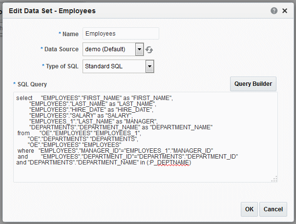

Add a Bind Variable Using a Text Editor
Use the Data Model Editor to update a SQL query.
  1. In the Edit Data Set dialog box, update the SQL query by adding the following after the where clause in your query:
    and "COLUMN_NAME" in (:PARAMETER_NAME)
    for example:
    and "DEPARTMENT_NAME" in (:P_DEPTNAME)
    where P_DEPTNAME is the name you choose for the parameter, as shown below.
  2. Click Save.
  3. In the data model editor, select the parameter that you entered with the bind variable syntax as shown in the image.
  4. Click OK to enable the data model editor create the parameter entry for you.

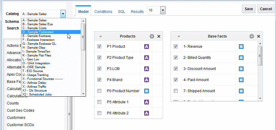

Define SQL Queries Against the Oracle BI Server
When you launch the Query Builder against the Oracle BI Server, the Query Builder displays the subject areas from the catalog. You can drag the subject areas to the Query Builder workspace to display the columns. Select the columns to include in your data model.
  1. In the data model editor, click New Dataset and then click SQL Query.
  2. Enter a name for the dataset.
  3. From the Data Source list, select the Oracle BI Server connection, usually shown as Oracle BI EE .
  4. Click Query Builder to launch the Query Builder page.
    You can also enter the SQL syntax manually in the SQL Query text box in the data model editor. However, you must use the Logical SQL syntax used by .
  5. From the Catalog drop-down list, select a subject area as shown below. The list displays the subject areas defined in the .
  6. Select tables and columns for the query.
  7. Click Save.
  8. Click OK to return to the data model editor. The generated SQL is Logical SQL that follows a star schema (that is, it isn't physical SQL).
