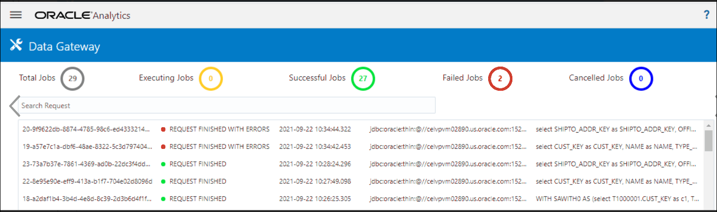

Diagnosing Connection Issues Using The Status Page
Use this page to review database requests that a Data Gateway agent makes with the remote database.
In a Data Gateway agent, click Navigator then Status to review database requests.
To diagnose issues, you typically search on date or job status:
  • To search on date, in the Search Request field, enter all or part of the date and time in the format "YYYY-MM-DD HH-MM-SS". For example, enter "2022-03-28" to look for entries for 28th March, 2022.
  • To search for failed jobs, in the Search Request field, enter "REQUEST FINISHED WITH ERRORS".
Clear the Search Request field to review all jobs.

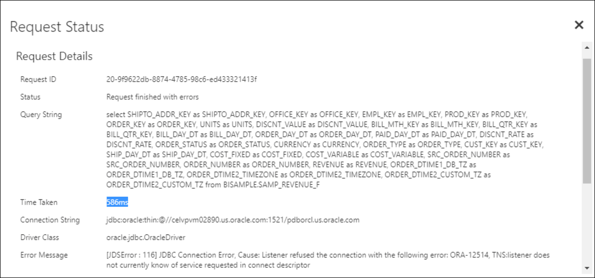

Click on a job to view the detailed status information.
Description of dg_status2.png follows

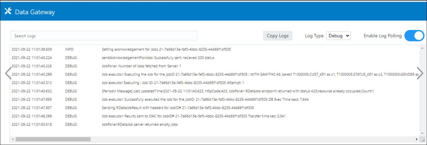

Diagnosing Connection Issues Using The Logs Page
Use this page to review a Data Gateway agent's log entries so that you can analyze connection traffic.
In a Data Gateway agent, click Navigator then Logs to review log entries. Enable the Enable Log Polling option and select an appropriate logging level. For example, to diagnose connection issues, you might set Log Type to Debug.
Description of dg_logs1.png follows
Oracle recommends that when you've completed your troubleshooting, you either disable Enable Log Polling or adjust the Log Type to capture less information.

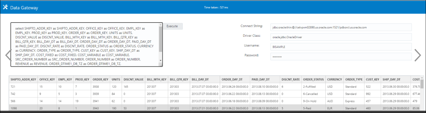

Diagnosing Connection Issues Using The Query Page
Use this page to query a remote database from a Data Gateway agent to test the connection and assess performance.
In a Data Gateway agent, click Navigator then Query to execute a SQL statement directly from the Data Gateway agent to the (on-premises) database. For example, you might copy the Query String, Connection String, and Driver Class from a failed job listed on the Status page. Supply the database credentials and execute the query to review the outcome and the performance statistics (Time taken). Note: The remote database must support connection using a JDBC connection string.

In the agent's Status page, you also see "REQUEST FINISHED WITH ERRORS", and if you click the requests, you see "[JDSError : 110] JDS - Invalid connect string / URL to external source, Cause: Invalid Oracle URL specified".

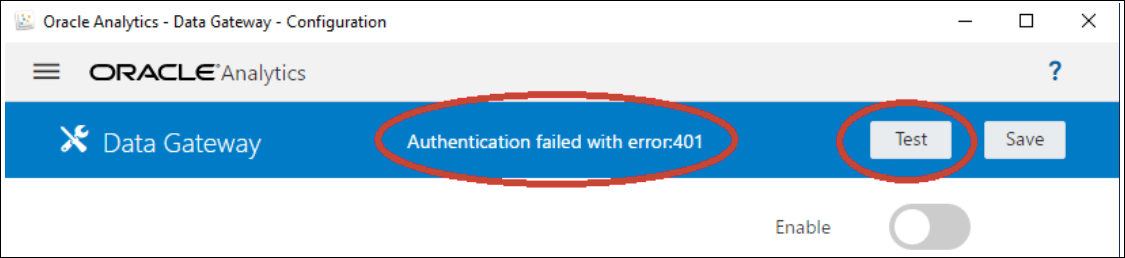

Authentication failed with error: 401" is returned on Test. Possible reasons include:
- The Data Gateway agent key hasn't been copied to the Remote Data Connectivity page in Oracle Analytics Cloud Console. For example, you might have clicked the Test button before pasting the key in the OAC > Console > Remote Data Connectivity page.
- The Data Gateway agent key has been regenerated, but the new key hasn't been copied to the Remote Data Connectivity page in Oracle Analytics Cloud Console. For example, you might have already registered a Data Gateway agent in the Remote Data Connectivity page in Console but its ID doesn't match the "id" of the key in the Data Gateway agent Home page.
Description of dg_error401.png follows
If the Data Gateway agent key hasn't been copied, paste the key in the Console to register the Agent.
If the Data Gateway agent key has been regenerated, delete the Data Gateway agent in the Console, then paste the key in the Console to re-register the agent.

Once you've found log entries, click on a job and review the Request Status dialog to see the Time Taken in milliseconds.
