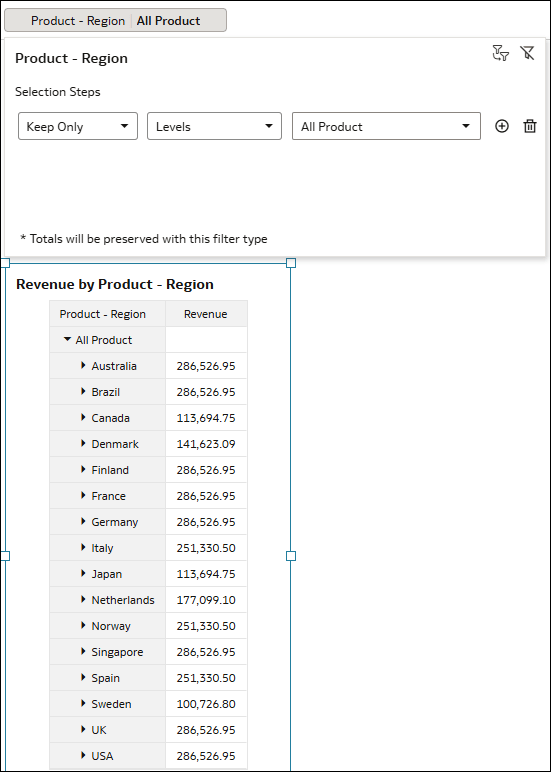

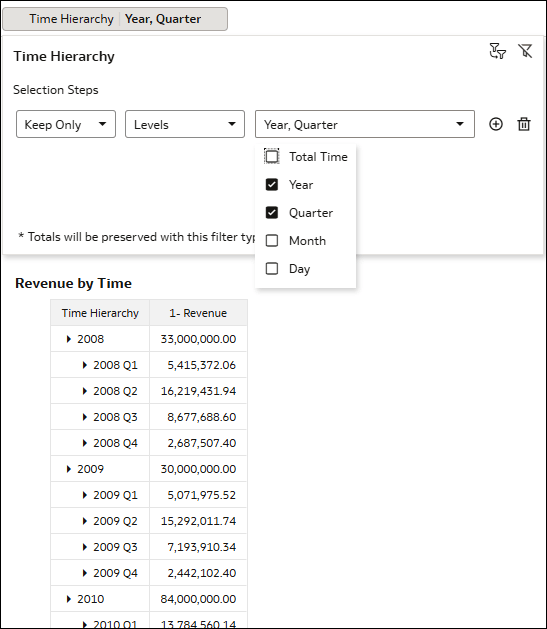

  • Levels
    Level hierarchy example: For a table showing revenue for a time dimension, if you use a selection step with the action Keep Only, the operator Levels, and the levels Year and Quarter, the table shows the revenue for each year and each quarter. You can expand the rows to see more granular levels, but you can’t see the higher levels.
    Description of selection-steps-lvlhierarchy-ex-levels.png follows

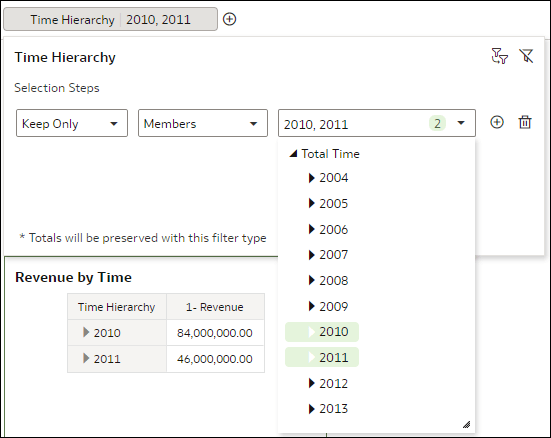

  • Members
    Level hierarchy example: For a table showing revenue for a time dimension, if you use a selection step with the action Keep Only, the operator Members, and the members 2010 and 2011, the table shows the revenue for only those two years.
    Description of selection-steps-lvlhierarchy-ex-members.png follows
