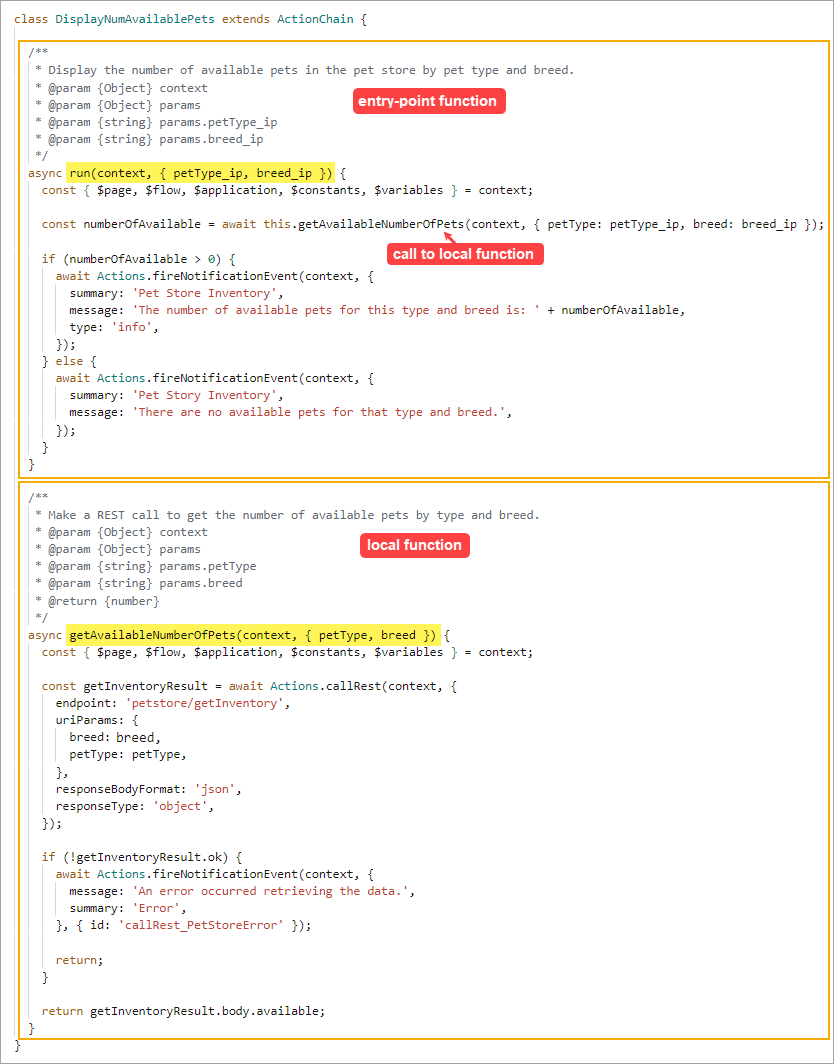

Local Functions
Should the need arise to break up the run() entry point function into modular parts, you can create local functions:
Description of jsac-local-function-code-example1.png follows
