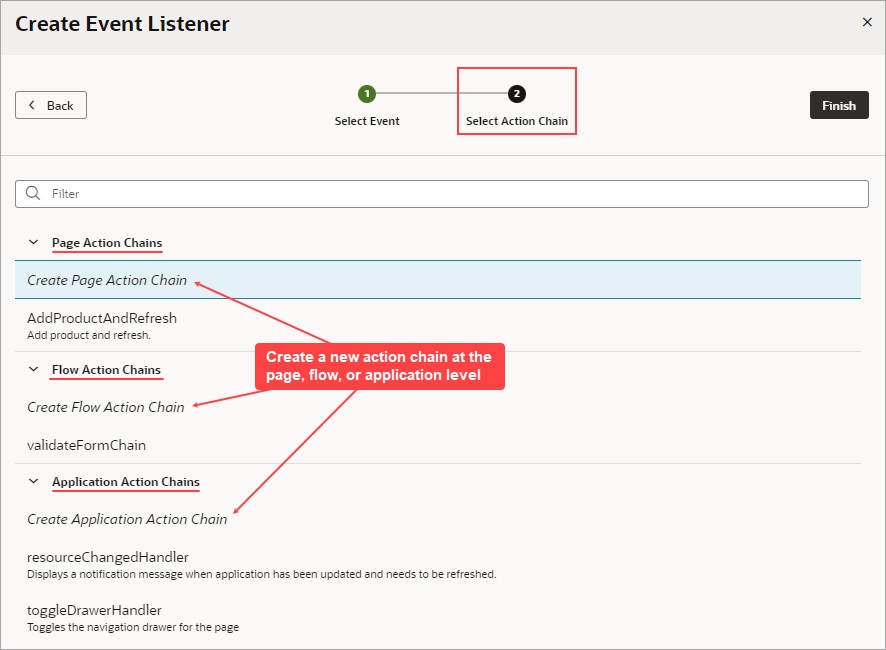

      To have your new action chain started by a lifecycle, application, flow, or page event (vbBeforeEnter, vbEnter, vbAfterNavigate...), select the Event Listeners tab and click + Event Listener. In the Create Event Listener wizard, select the event and click Next. On the wizard's Select Action Chain step, select the create action chain option at the appropriate level (page, flow, or application) and click Finish. For further details, see Start an Action Chain From a Lifecycle Event.
      Description of jsac-create-action-chain-wizard1.jpg follows

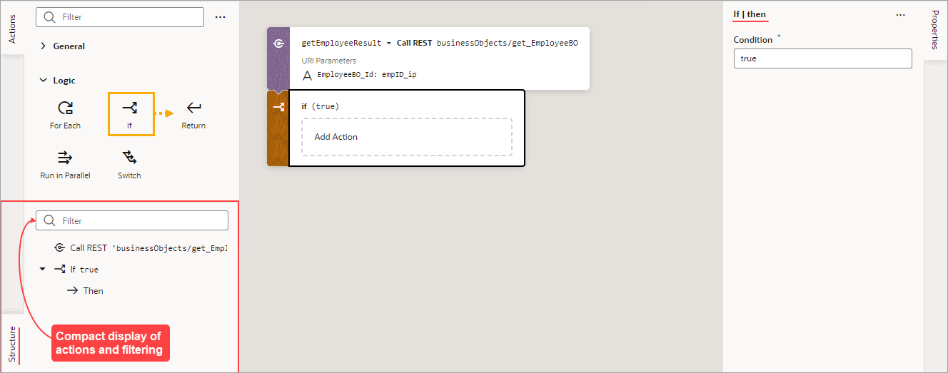

    As shown above, the Structure pane displays a compact view of the actions and it provides a filter to quickly find and select an action.

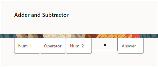

In this example, we implement this Adder and Subtractor interface by creating an action chain that either adds or subtracts two numbers and displays the result:
Description of jsac-adder-subtractor-interface1.jpg follows
The interface has:
  • Four text components:
    • Two for entering the numbers to add or subtract (Num. 1, Num. 2)
    • One for entering either a plus or minus sign (Operator)
    • One to display the result (Answer)
  • One button (=) that triggers the action chain that performs the operation and displays the result

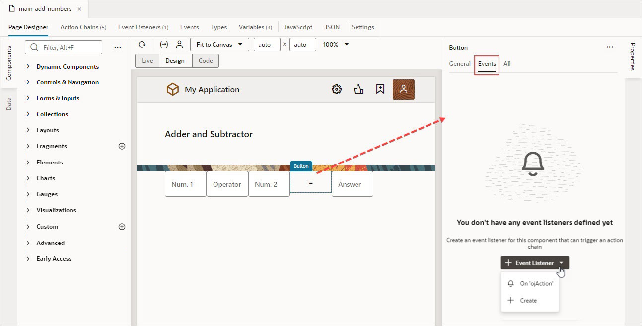

  1. We want the action chain to be triggered by clicking the equals button, so select the equals button on the Page Designer’s canvas, then select the Events tab in the Properties pane:
  2. Click + Event Listener, then On ‘ojAction’ to create an event that’s triggered by clicking the button, as shown above.
    The new action chain opens in the Action Chain editor.

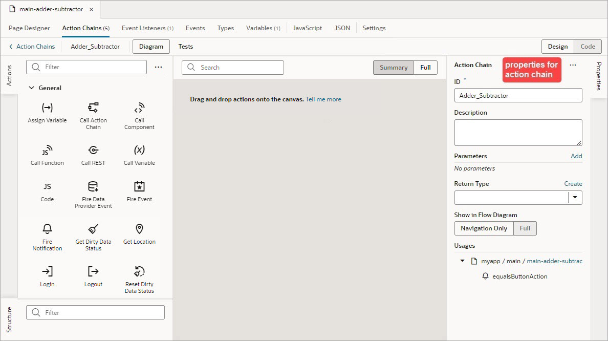

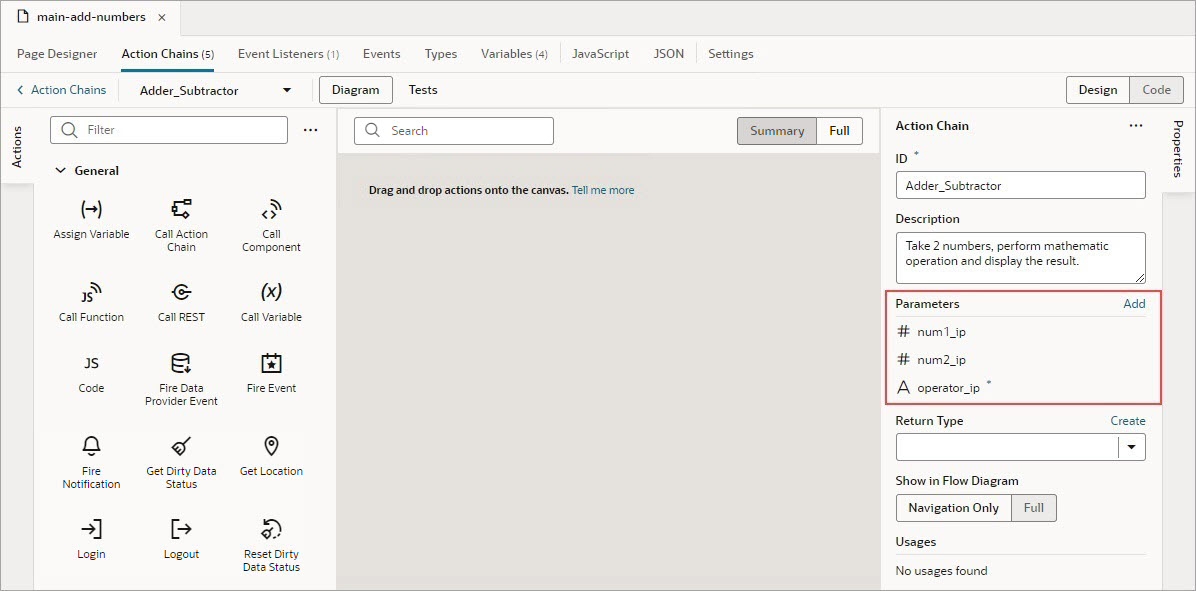

  3. Using the Properties pane, enter Adder_Subtractor for the action chain’s ID field, and optionally a description.
  4. Since three input parameters are needed, two for the numbers and one for the operator, you need to add them using the Add link next to the Parameters property in the Properties pane:
    Nothing needs to be returned by this action chain, so we don’t need to define a return type.

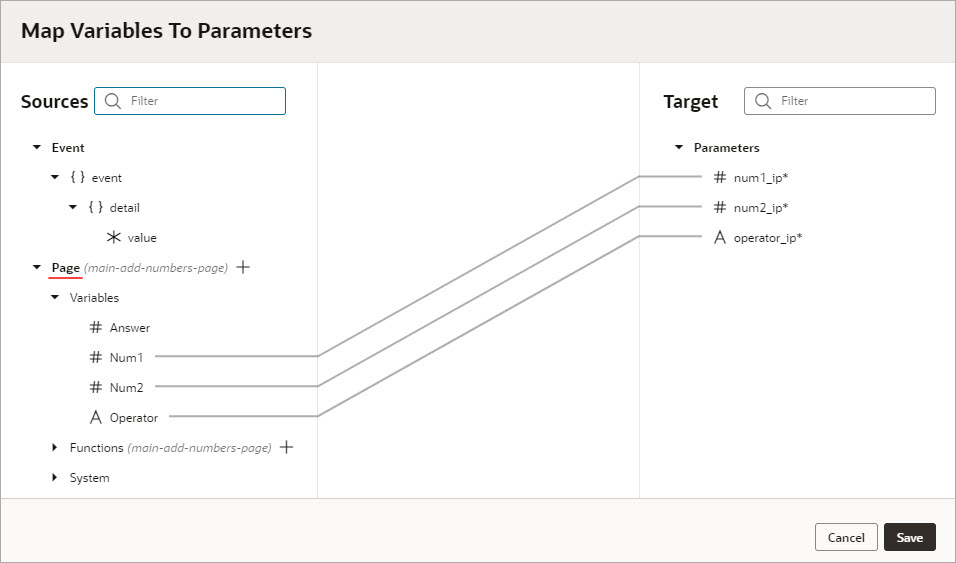

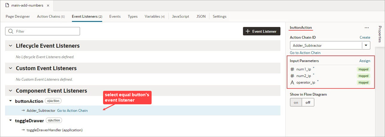

  5. Next, you need to provide the values for your input parameters. Open the Event Listeners tab and select the equal button’s event listener. In the Properties pane, click the Assign link for the Input Parameters property:
  6. In the mapper, map the page variables that were bound to the text components for the numbers and the operator to the action chain’s input parameters:

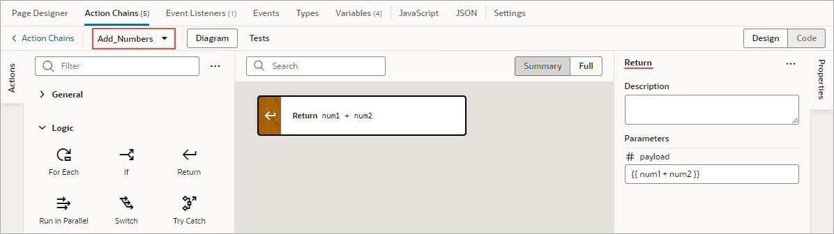

  12. To implement the Add_Numbers action chain:
    1. In the Properties pane, click the Add link for the Parameters property and add two input parameters for the numbers to add: num1 and num2.
    2. Since the action chain needs to return a number, define its return type by selecting Number for Return Type.
    3. Drag and drop the Return action from the Actions palette onto the canvas. In the Properties pane, enter {{ num1 + num2 }} for the Payload property to return the sum of the two input parameters. Recall, wrapping the expression with double curly brackets indicates that it’s a literal expression and not a string:

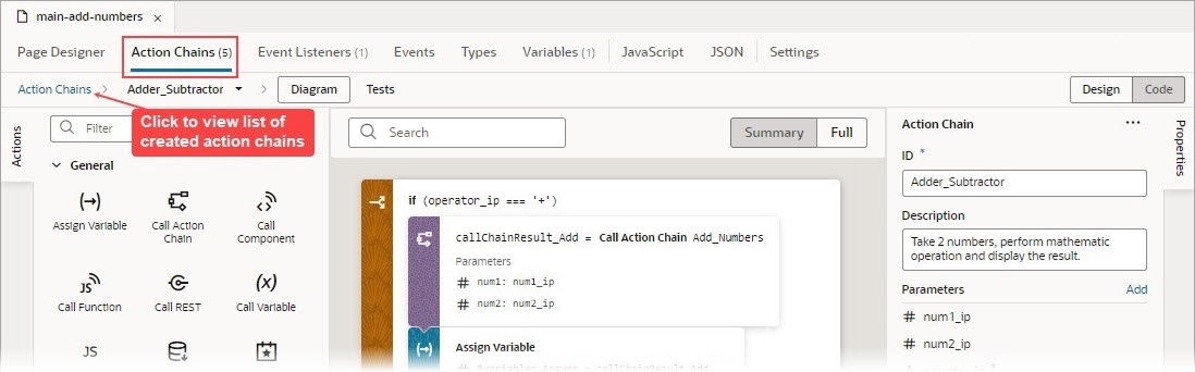

  13. Navigate back to the Adder_Subtractor action chain by clicking the Action Chains link at the top-left of the editor and selecting the action chain.
    The editor is now loaded with the Adder_Subtractor action chain.

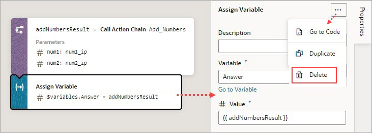

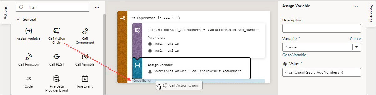

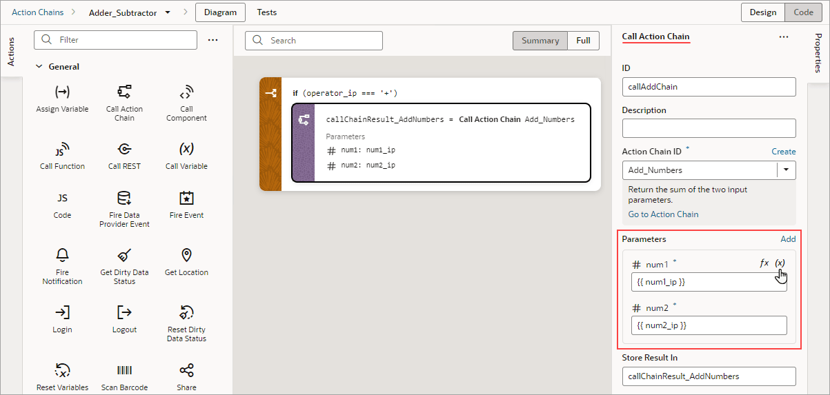

  14. The two numbers that were passed as input parameters to the Adder_Subtractor action chain now need to be passed to the Add_Numbers action chain. Select the Call Action Chain action on the canvas, and in the Properties pane, for the Parameters property, select the number input parameters:
    You now need to assign the result from the Add_Numbers action chain to the page variable that’s bound to the text component that displays the answer.
  15. Drag and drop the Assign Variables action to the bottom edge of the Call Action Chain action on the canvas. For the Variable property, in the Properties pane, select the page variable that’s bound to the text component displaying the answer, and for the Value property, select the result from the Add_Numbers action chain:
