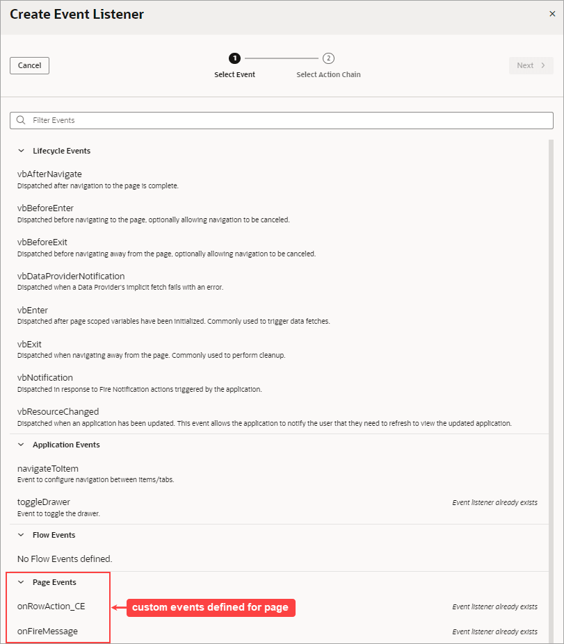

- Create a custom event, defining parameters if required.
- Create an event listener, which can start more than one action chain:
- In the Create Event Listener wizard, assign the event listener the custom event:
- Create an action chain for the custom event, which will be started when the event is triggered by a Fire Event action. Create the action chain through the Event Listener tab, because if the listener's custom event has input parameters, the action chain is created with and passed an
eventobject that contains the input parameters (example:event.param1,event.param2...).

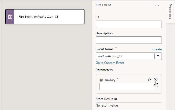

To use a Fire Event Action:
- Add the action in one of three ways, as explained at the end of Built-In Actions.
- In the Properties pane, select an existing event from the Event Name list of available events, or click Create to create a new custom event at the appropriate scope level (page, flow, or application). The list contains events that are available within the current scope.
- If the event has input parameters, the Parameters property is shown. To pass in a parameter, hover over the far-right side of the parameter and click
to choose the variable. If you need to create a variable, use a Create link in the Variables dialogue to create it at the appropriate scope level. - If the event returns a value, it is assigned to the auto-generated variable shown by the Store Result In property.
