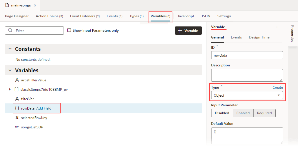

  1. Create a page variable of type Object to hold the selected row's data:

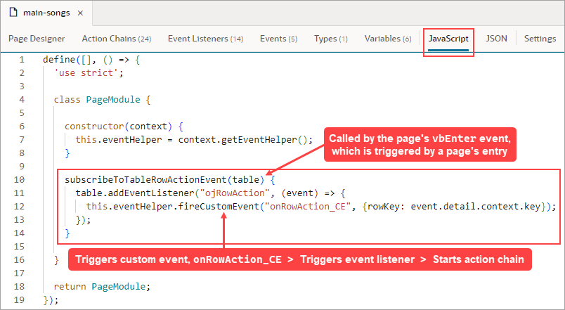

  2. Create a JavaScript function (module function) to subscribe to the table's ojRowAction event, which is triggered when a user clicks a table's row. You'll use this ojRowAction event to trigger your custom event, which will start the action chain that saves the row's data to the rowData page variable.
    To create the function, select the JavaScript tab. Use the context's eventHelper object's fireCustomEvent() method to trigger your custom event and to pass the required payload. The event parameter contains the row's data (event.detail.context.data).
    Here's the example code:
        constructor(context) {
          this.eventHelper = context.getEventHelper();
        subscribeToTableRowActionEvent(table) {
          table.addEventListener("ojRowAction", (event) => {
            this.eventHelper.fireCustomEvent("onRowAction_CustomEvent", {rowData: event.detail.context.data});

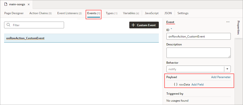

  5. Now create the custom event that will be triggered by the table's ojRowAction event. You'll also create the action chain that assigns the row's data to the rowData page variable.
    1. On the page's Events tab, click + Custom Event to create a custom event. In the Properties pane, click the Payload property's Add Parameter link and define an input parameter of type Object. This input parameter will be used to pass the row's data to the action chain that assigns the data to the rowData page variable.
    2. For the custom event's Behavior property, set whether the action chain runs serially or in parallel. The default, notify, is in parallel. For details about each option, see Choose How Custom Events Call Event Listeners.

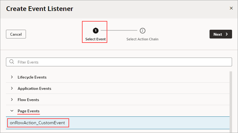

  6. Create an event listener for the event to specify which action chains to start when the event occurs (more than one action chain can be started by an event listener).
    1. On the page's Event Listeners tab, click + Event Listener.
    2. In the Select Event step, scroll down to Page Events and select the custom event that you created. Click Next.
    3. In the Select Action Chain step, click the Add icon next to Page Action Chains.

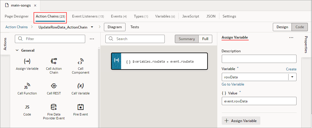

      When a listener’s action chain is created here, if the listener's custom event has input parameters, the action chain is created with an event input parameter. This event object contains the custom event's input parameters (example: event.param1, event.param2...), and the event object is automatically passed to the new action chain.
    4. In the Action Chain editor, note that the action chain has the event input parameter, which contains the custom event's input parameter. Add the Assign Variable action, set its Variable property to the page variable that will contain the row's data, then set its Value to the relevant value in the event object that was passed to the action chain:
