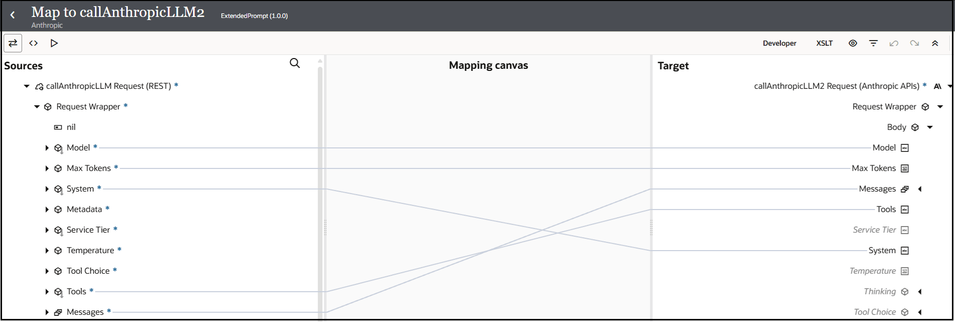

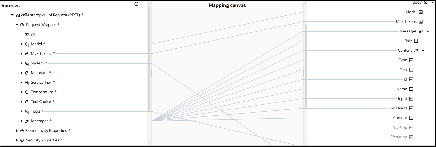

- Open the request mapper automatically created when the Anthropic Adapter invoke connection was added to the integration. The mapper that was automatically created with the REST Adapter trigger connection is not edited and remains empty in this use case.
- In the request mapper, map the source Request Wrapper
elements to the target Request Wrapper elements.
- Expand the target Messages, and then
Content, to view the contents of the message.
The Content elements within Messages specify the actual textual input or output for the conversation with the Claude model.

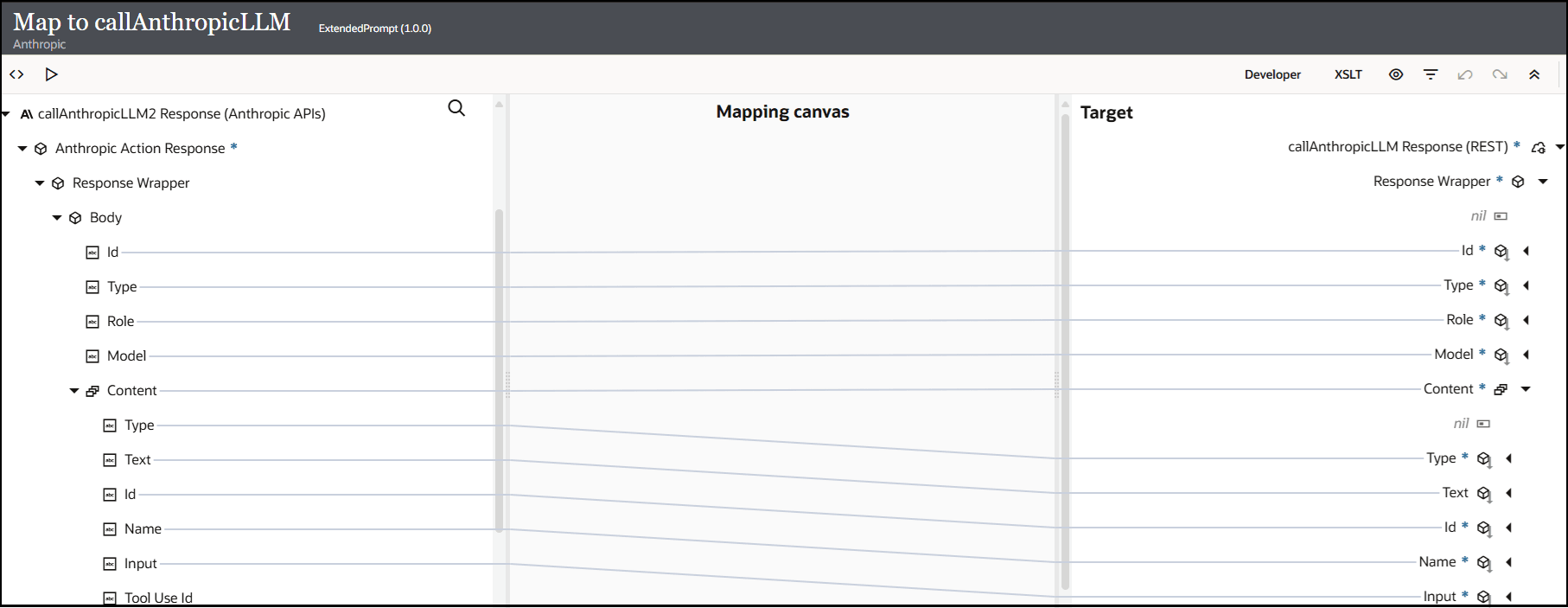

- Add a response mapper.
- In the response mapper, map the source Response Wrapper
elements to the target Response Wrapper elements.

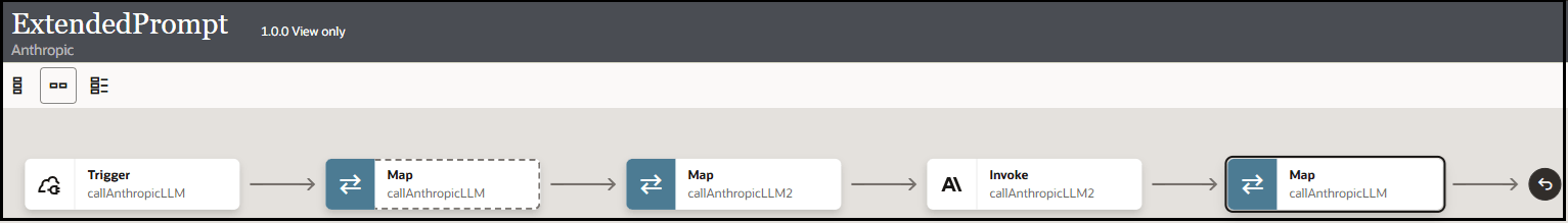

The completed integration looks as follows:

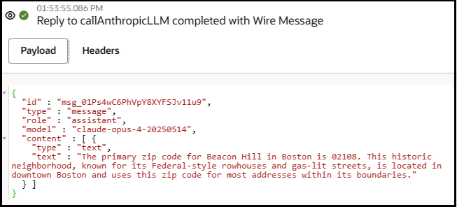

menu, select Run.The Configure and run page appears. - In the Body field of the Request
section, enter the following text, then click Run.

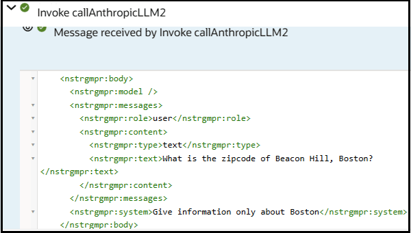

{ "system": "Give information only about Boston", "messages": [ { "role": "user", "content": [{"type": "text", "text": "What is the zipcode of Beacon Hill, Boston?"}] } ] }The Body field of the Response section returns the following output.{ "id" : "msg_01Ps4wC6PhVpY8XYFSJv11u9", "type" : "message", "role" : "assistant", "model" : "claude-opus-4-20250514", "content" : [ { "type" : "text", "text" : "The primary zip code for Beacon Hill in Boston is 02108. This historic neighborhood, known for its Federal-style rowhouses and gas-lit streets, is located in downtown Boston and uses this zip code for most addresses within its boundaries." } ] } - Expand the activity stream to view the flow of the messages sent and
received.
- The message received by the invoke connection for delivery
to the Anthropic model includes the following content:

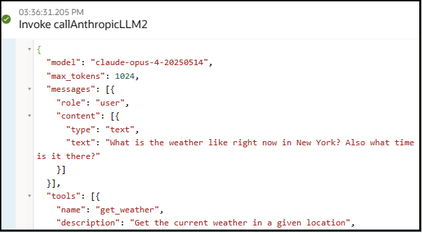

toolsparameter to invoke functions to get the weather report and the time of day for a specific location. This example also shows how you can manage conversations that span multiple prompts. By chaining prompts together, you can break down complex tasks into smaller, more manageable subtasks. - The message received by the invoke connection for delivery
