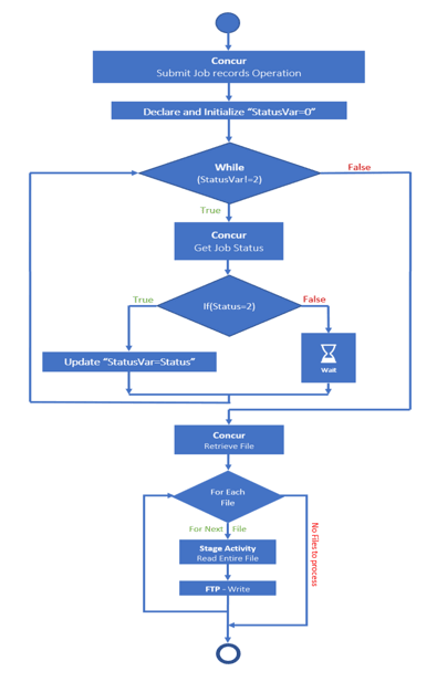

This use case provides a high level overview of how to submit a job, get job status, and retrieve the extract data of the job created by using the SAP Concur Adapter Extract API.
Description of concur-int-oview.png follows
  1. Select and configure the SAP Concur Adapter on the Connections page.
  2. Create a schedule integration.
  3. Drag the SAP Concur Adapter into the integration as an invoke connection.
    1. On the API Option page, select Extract API.
      This API enables you to request the extract of available data objects, such as approved expense reports, travel requests, and payment requests.
    2. On the Operations page, select SumbitJobRequest from the Select Operation list to configure the SAP Concur Adapter to submit the job.
  4. In the request mapper, map startTime to POST.
  5. Add an assign activity.
    1. Create two variables to store the status of the job (for this example, named done) and a file link to retrieve the file (for this example, named Filelikvar).
  6. Configure a while action below the assign action to check the status for the submitted job.
    1. Configure the condition for the status (“done! =2”).
      The status of the job is 2 if the job is completed. This is returned by SAP Concur.
  7. Drag a second SAP Concur Adapter inside the while loop and configure the adapter to get the job status.
    2. On the Operations page, select GetJobStatus from the Select Operation list.
  8. Map status-link from the SubmitJobRequest operation’s response to JobStatusLink in the request of the GetJobStatus operation.
  9. Drag a switch action into the integration.
    1. Configure the condition for the status variable to check the job status.
  10. Drag an assign action in the switch action to update the status.
    If the status is completed (that is, status = ”2”), it is updated in the variable created in Step 5.
    1. Update done to status and Filelikvar to file-link.
    2. In the Otherwise condition of the switch action, drag a wait action.
    3. Configure the wait action to wait for 2 minutes.
  11. Drag a third SAP Concur Adapter connection outside of the while action.
    2. On the Operations page, select the RetrieveFile operation. The RetrieveFile operation downloads the file to a virtual file system (VFS) directory. The VFS location of the downloaded file is returned in the response of the RetrieveFile operation along with the file(s) name.
  12. In the mapper, map $Filelikvar to file-link.
  13. Drag a for-each action into the integration.
    1. Name the activity (for this example, foreach is entered).
    2. Drag the files element from the response of RetrieveFile to the Repeating Element field.
    3. Enter a name in the Current Element Name field (for this example, FileTemp is entered).
    4. Click Create and complete for-each action configuration.
  14. Drag a stage file action inside the for-each action to read the downloaded result.
    1. Provide a name, and then click Next.
    2. Select Read Entire File from the list.
    3. In the Specify the File Name field, provide the file name for the stage file action response.
    4. For the Specify the Directory to read from field, provide a file location.
      You now create a schema based on the sample headers mentioned on the Summary page of the SubmitJobRequest operation for each extract.
    5. On the Schema Options page, select Create a new schema from a CSV file, which maintains the response file structure.
    6. On the Schema Options page, select the CSV file.
    7. Check the configuration in the Summary page.
  15. Drag an FTP Adapter connection below the stage file action configured to read the retrieved files.
    1. On the Operations page, select the Write File operation.
    2. On the Schema page, select to create a new schema.
    3. On the Format Definition page, select a sample CSV file that maintains the response file structure (for this example, InvoiceGLEExtract.csv is selected). This is the same CSV file selected for the stage file action.
  16. In the mapper, map the stage file action response elements to FTP Adapter request elements.
  17. Add the tracking variable:
    1. In the upper-right corner, select Tracking from the Actions menu.
    2. Drag a tracking variable.
  18. Activate the integration.
  19. From the Actions menu at the far right for this integration, select Submit Now.
    You receive a run ID. You can monitor the flow using this run ID.
    The integration is deployed and the web service is ready to accept requests.
