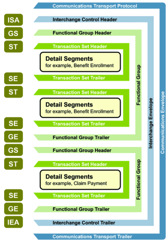

From highest to lowest, the structure is as follows:
  • Interchange envelope
  • Functional group
  • Transaction set
The following diagram shows a schematic structure of X12 envelopes. Each of these levels is explained in further detail.
Description of x12-env-structure.png follows

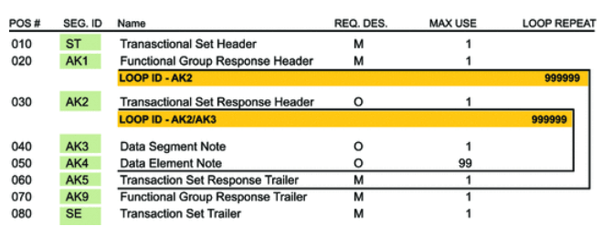

The following example shows the standard segment table for an X12 997 (Functional Acknowledgment) as it appears in the X12 standard and in most industry-specific implementation guides.
A table is displayed with columns for POS #, SEG. ID, Name, REQ DES, MAX USE, and LOOP REPEAT. There are eight entries. The name of LOOP ID - AK2 is highlighted. It has a LOOP REPEAT value of 999999. The name of LOOP ID - AK2/AK3 is also highlighted. It has a LOOP REPEAT value of 999999.

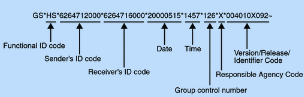

The following example shows a functional group header (GS).
The parts of the overall functional group header value are identified by the Functional ID code, the Sender's ID code, the Receiver's ID code, the Date, the Time, the Group control number, the Responsible Agency Code, and the Version/Release/Identifier Code.

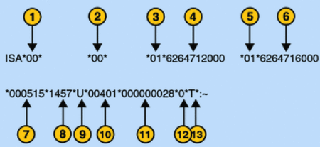

The following example shows an interchange header (ISA).
The parts of the overall interchange header value are identified immediately below.
The following list describes the ISA segments:
  1. Authorization information qualifier
  2. Security information qualifier
  3. Interchange ID qualifier
  4. Interchange sender ID
  5. Interchange ID qualifier
  6. Interchange receiver ID
  7. Date
  8. Time
  9. Repetition separator
  10. Interchange control version number
  11. Interchange control number
  12. Acknowledgment requested
  13. Usage indicator
