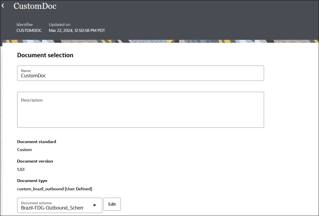

    The document details page for your new B2B document using the Custom standard is displayed.
    The page shows the Identifier and Updated by labels at the top. In the Document Selection section are fields for Name and Description. Below this are the values selected for Document standard, Document version, and Document type. Below this is a list for Document schema and the Edit button.
  4. If you want to use a different document schema, select an existing schema from the Document schema drop-down list or click Edit to upload a new schema file.
