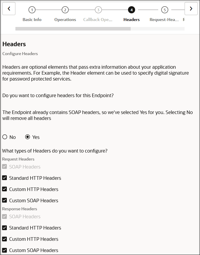

Create a Co-located Integration with Header Support

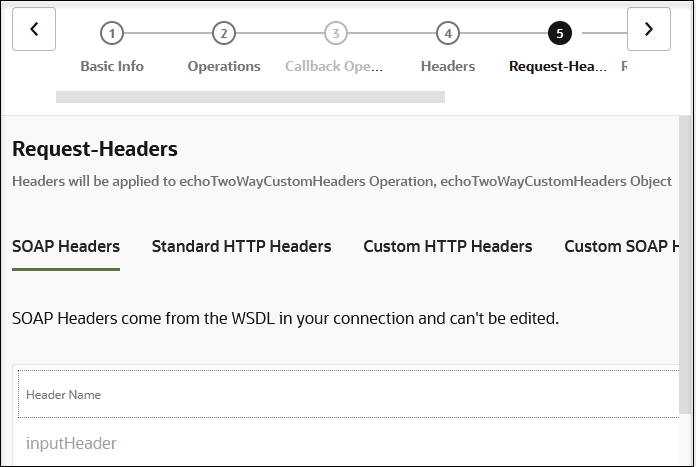

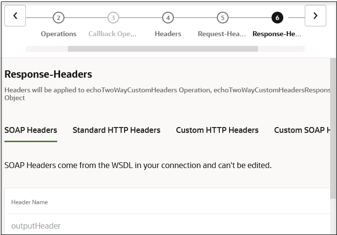

Headers are optional elements that pass extra information about your application requirements. For example, you can use the header element to specify a digital signature for password-protected services. You can configure and select the headers to send with the payload. Header selection is automatic based on the WSDL URL definition you provide on the Connections page.
Along with request and response SOAP and REST headers, you can configure standard HTTP headers with the SOAP Adapter and REST Adapter, custom HTTP headers with the SOAP Adapter and REST Adapter, and custom SOAP headers. You can view and edit these headers in the request and response mapper under the header elements for either the SOAP Adapter or REST Adapter.
The following use case provides a high-level overview of creating a co-located integration with header support.Backward Compatibility for Header Support

| What happens if an existing integration created with a header is imported into an environment in which header support in co-located integrations is supported. | You can activate the integration without any issues. However, if you want to use header functionality, you must edit the adapter by clicking through the pages of the Adapter Endpoint Configuration Wizard, then clicking Done on the Summary page. In this scenario, mapping is not deleted; you must to correct it. |
What happens if you perform the following steps.
Based on the selection of Yes or No, headers are visible or invisible in the mapping. |

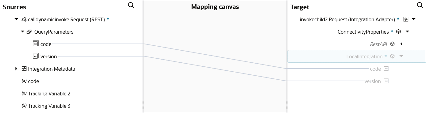

Dynamically Invoke a Child Integration
You can dynamically invoke a (co-located) child integration at runtime. In this example, a parent integration can call either of two child integrations at runtime based on the data. The parent integration is designed to invoke child integration one. However, it can also invoke child integration two. The code and version values are passed to the appropriate child integration.
Dynamic invocations are only supported with the REST Adapter.- Create and activate an initial child integration with a REST Adapter trigger connection.

- Perform mappings in the mapper.
- Activate the integration.
