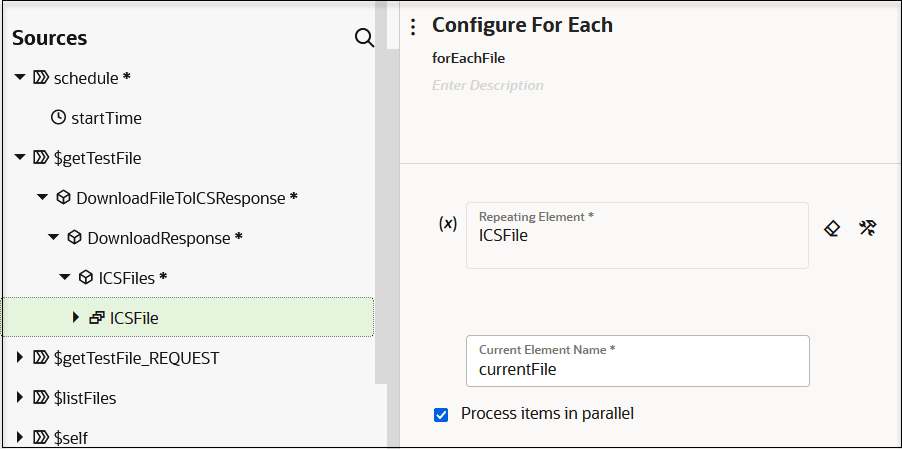

  2. Click Edit Edit icon under Configure For Each to enter a name and optional description for the for-each action.
  3. Expand the Sources tree to select an element.
  4. Drag a repeatable element to the Repeating Element field. This is the element over which to loop.
    Note the following restrictions:
    • The selected element must be repetitive. You can identify repetitive elements by the three-box icon to the left of the element name.
      The process element is expanded to show the repeating element.
    • Any parent of the selected element must not be repetitive.
    • The data type of the selected element must be scalar.
    • Global and nonglobal repeated elements can be selected.
    • If you have a repeating element within another repeating element (that is, a list within a list), you must first create a for-each action and loop over the parent list. This gives you access to the child list during every iteration. You can then create a second for-each action within the scope of the first for-each action and loop over the child list.

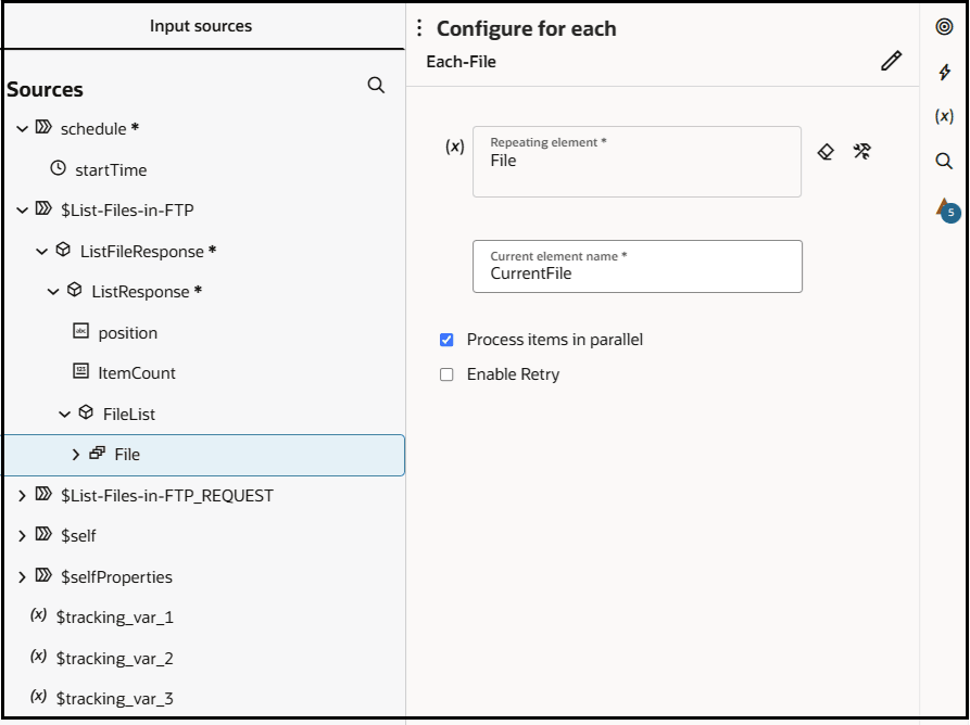

    For this example, the element over which to loop is File.
    For every iteration of the loop, there is a single reference to the repeating element (File). A current element name file is required for this action to occur.
  5. Enter an alias for the current file of the iteration in the Current element name field.
    The repeatable element under Sources is dragged to the Repeating Element field. Below this the Current Element Name field shows a value of currentFile. Below this are the Process items in parallel and Enable retry check boxes.
  6. If you drag a for-each action into a schedule integration, the Process items in parallel check box is displayed.
    When selected, iterations of the for-each action are run in parallel. For example, if an integration processes a list of files with a for-each loop created over every file, the processing of the entire file is done in parallel for every file. If a variable is declared outside a for-each loop with Process items in parallel selected and updated within the for-each loop, the last updated value for that variable is available outside of the loop. Also, the degree of parallelism (DOP) is set to 1 to avoid concurrency issues.
  7. If this is a schedule integration, select the Enable Retry check box if you want to automatically retry a for-each action if a branch error occurs during runtime. Up to three retries are supported. If this check box is not selected, a retry is not initiated when a branch error occurs and the error is shown in the activity stream.
  8. Click Save.

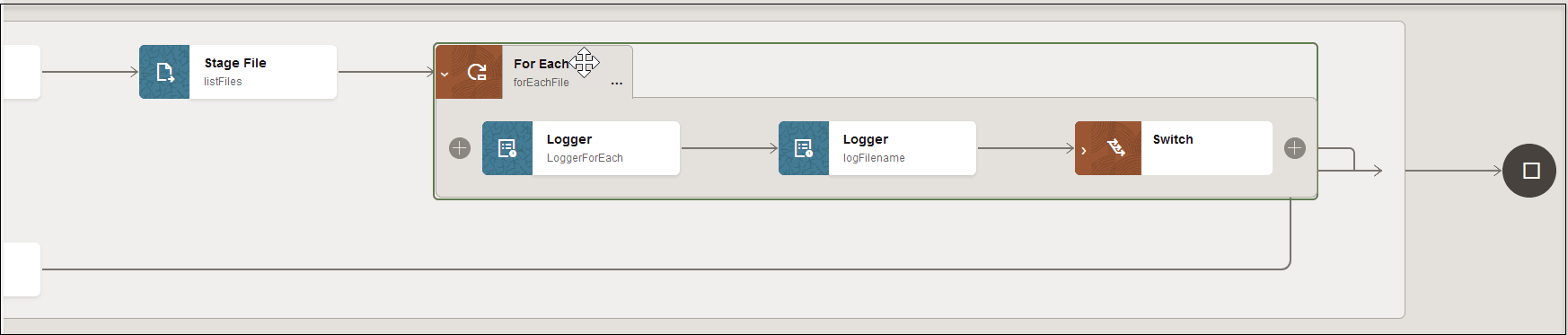

    The for-each action is displayed in the canvas. A looping arrow indicates that this action performs repetitive looping.
  9. Click + inside the for-each action to add additional actions. These actions define what happens during each iteration of the loop. For this example, scope and switch actions are defined within the for-each action.
