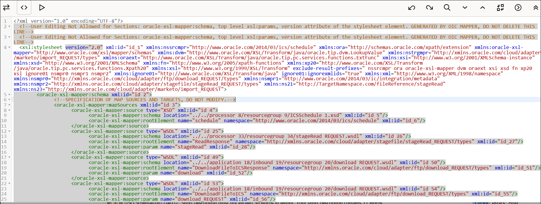

  1. Click Code.
    The current XSLT code for your mappings is displayed.
    This image shows the XSLT code view of your mappings. Sections at the very top of the code do not allow editing. Above the code are three icons to the left and eight icons to the right.

The following sections of your XSLT code remain read-only and cannot be edited.
  • Attribute version numbers:
    <xsl:stylesheet version="2.0"
  • The mapper schema section where sources and targets are specified:
    <oracle-xsl-mapper:schema xml:id="id_2">
                  <!--SPECIFICATION OF MAP SOURCES AND TARGETS, DO NOT MODIFY.-->

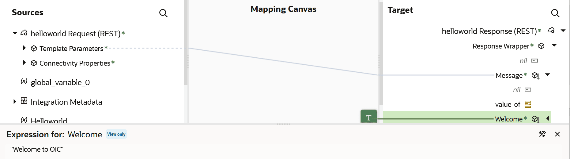

For example, assume you have the following XSLT code that you want to replace:
<nstrgdfl:Welcome
             <nstrgdfl:Welcome xml:id="id_19">"Welcome to OIC!!! Echo was successful."
</nstrgdfl:Welcome>
This code is currently visible in the mapper as literal text:
The TemplateParameters element in the source section is mapped to the Message element in the target section. Below is the Expression Builder section with a string value of Welcome to OIC.

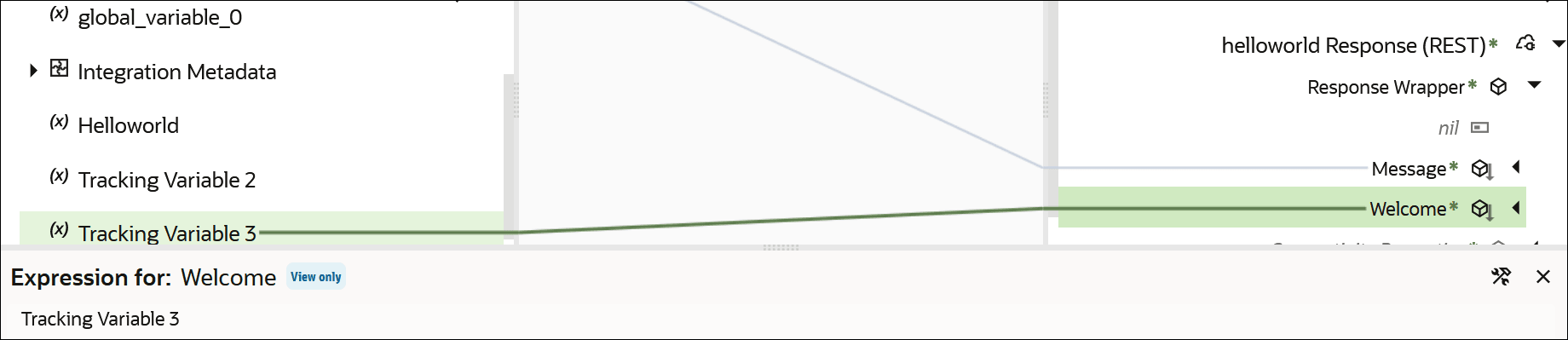

  1. Replace the literal value of "Welcome to OIC" with the variable $tracking_var_3:
                 <xsl:value-of select="$tracking_var_3" xml:id="id_18"/>
    </nstrgdfl:Welcome>
  2. Click Designer Designer mode icon.
    The designer is updated to reflect your changes:
    The Tracking Variable 3 source element is mapped to the Welcome target element. Below is the Expression Builder section with a value of Tracking Variable 3. At the far right are two icons.
