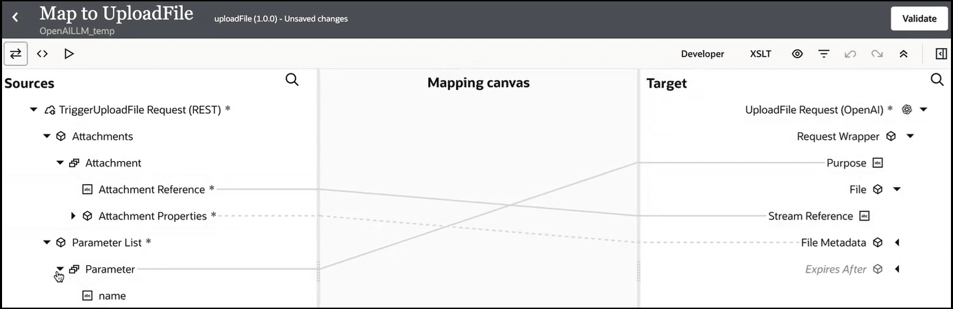

  4. Open the request mapper, and map the following source elements to target elements.
    • The source Attachment Reference element is mapped to the target Stream Reference element. These elements are displayed because of the multipart selections made on the Request page when defining the REST Adapter trigger connection.
    • The source Parameter element is mapped to the target Purpose element. The Purpose element is required. It describes the intended purpose of the uploaded file and is part of the Upload file API. See Upload file.
    Three icons are shown at the top left. The Developer link, XSLT link, and six other icons are shown at the top right. Above these icons is the Validate icon. Below this, the Sources, Mapping canvas, and Target sections are shown. The source Attachment Reference is mapped to the target Stream Reference. The source Parameter is mapped to the target Purpose.

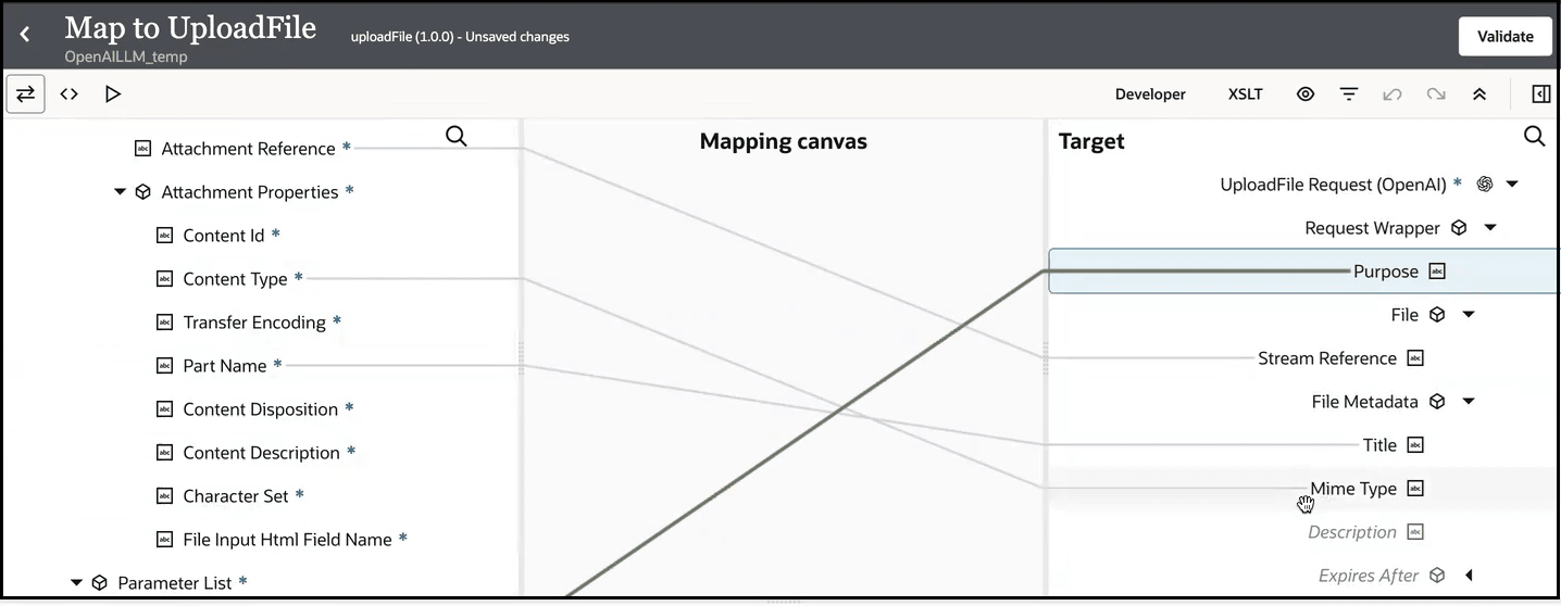

  5. Expand the source Attachment Properties element, and map the source Body elements to the target elements to define file metadata. The Part Name element mapping is required, but the other elements are optional.
    Three icons are shown at the top left. The Developer link, XSLT link, and six other icons are shown at the top right. Above these icons is the Validate icon. Below this, the Sources, Mapping canvas, and Target sections are shown. The source Attachment Properties is expanded, and source elements are mapped to File Metadata target elements.

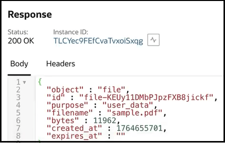

  10. From the Actions Actions icon menu, select Run.
    The Configure and run page appears.
  11. In the Body field of the Request section, define the following content, then click Run.
    1. Deselect the default files parameter. This action is required because OpenAI expects the parameter name to be file, and not files.
    2. Add a new parameter named file, and select File from the list.
    3. Upload the attachment file (for this example, sample.pdf is selected).
    4. Add a new parameter named purpose, select Text from the list, and enter an OpenAI-supported value for this parameter (for this example, user_data is entered). For the list of supported values, see Upload file.
      The Request section includes tabs for URI parameters, Headers, Body (which is selected), cURL, and Integration properties. The files parameter is deselected. The file parameter is defined with a type of File and an uploaded file. The purpose parameter is defined with a type of Text and a value of user_data.
      The Body field of the Response section returns the following output. The id parameter uniquely identifies the value for the uploaded file.
      The Response section shows a status of 200 and the instance ID. below this is the Body tab (which is selected) and the Headers tab. The Body tab shows the output returned from running the integration.

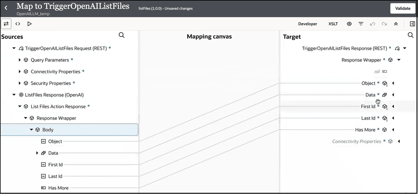

  6. Open the response mapper.
  7. Map the following source Body elements under ListFiles Response (OpenAI) to the target elements.
    Three icons are shown at the top left. The Developer link, XSLT link, and six other icons are shown at the top right. Above these icons is the Validate icon. Below this, the Sources, Mapping canvas, and Target sections are shown. The source ListFiles Response (OpenAI) is expanded, and source Body elements are mapped to File Response Wrapper target elements.
  8. Expand the target Data element and perform additional mapping.
    Three icons are shown at the top left. The Developer link, XSLT link, and six other icons are shown at the top right. Above these icons is the Validate icon. Below this, the Sources, Mapping canvas, and Target sections are shown. The source ListFiles Response (OpenAI) is expanded, and source Body elements are mapped to Response Wrapper target elements.

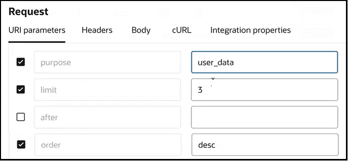

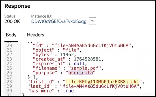

  11. In the URI parameters field of the Request section, select the query parameters to use, specify values, and click Run. For this example, the following parameters are defined.
    The Request section includes tabs for URI parameters (which is selected), Headers, Body, cURL, and Integration properties. The purpose, limit, after, and order parameters are shown. Values are defined for purpose, limit, and order.
  12. View your results. Three entries in which purpose is defined as user_data are displayed in descending order in the Response section. Here is a small portion of the output. Note that the original ID of the file uploaded (first_id) in Upload a File is automatically displayed.
