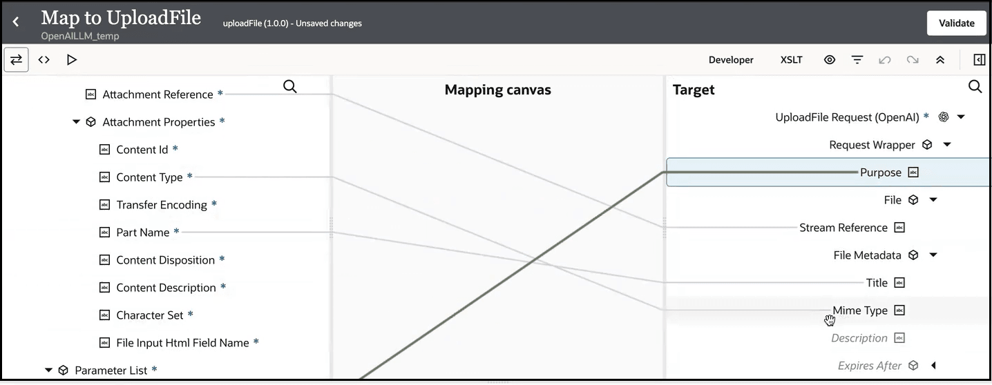

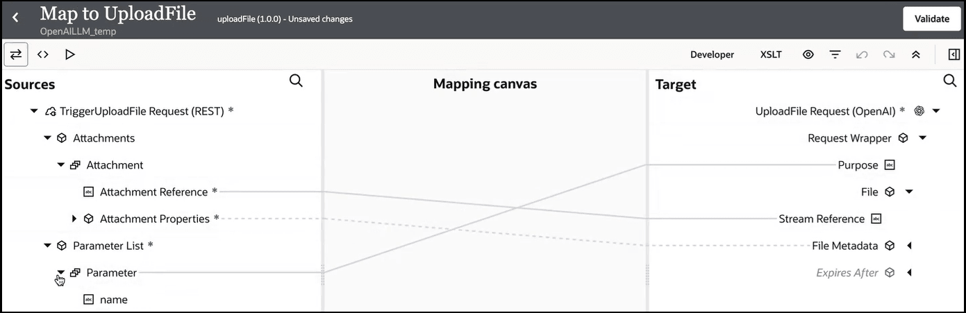

- Open the request mapper, and map the following source elements to
target elements.
- The source Attachment Reference element is mapped to the target Stream Reference element. These elements are displayed because of the multipart selections made on the Request page when defining the REST Adapter trigger connection.
- The source Parameter element is mapped to the target Purpose element. The Purpose element is required. It describes the intended purpose of the uploaded file and is part of the Upload file API. See Upload file.
- Expand the source Attachment Properties
element, and map the source Body elements to the target
elements to define file metadata. The Part Name element
mapping is required, but the other elements are optional.

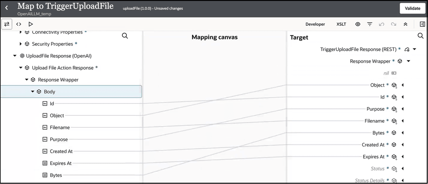

- Open the response mapper.
- Map the source Body elements under UploadFile Response (OpenAI) to the target elements.
These elements are the parameters defined in the Upload file API response structure. See Upload file.

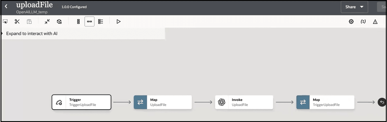

The completed integration looks as follows:

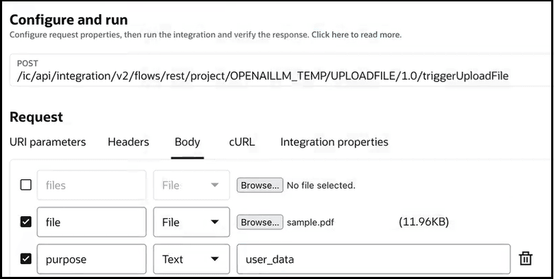

- In the Body field of the
Request section, define the following content, then
click Run.
- Deselect the default files parameter. This action is required because OpenAI expects the parameter name to be file, and not files.
- Add a new parameter named
file, and select File from the list. - Upload the attachment file (for this example,
sample.pdfis selected). - Add a new parameter named
purpose, select Text from the list, and enter an OpenAI-supported value for this parameter (for this example,user_datais entered). For the list of supported values, see Upload file.

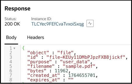

The Body field of the Response section returns the following output. The
idparameter uniquely identifies the value for the uploaded file.

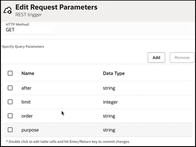

- The Request Parameters page lists the query parameters defined by the List files API. Select the appropriate parameters to use based on your requirements. See List files.

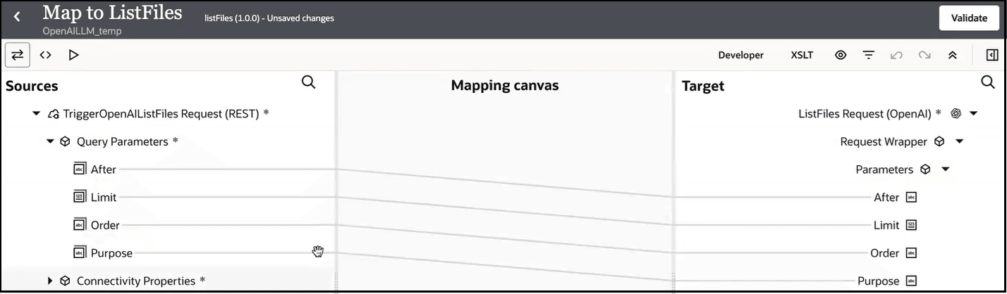

- Map the query parameters. These are the parameters that where
displayed on the Request Parameters page when you configured the REST Adapter invoke connection. If you do not map any of
these parameters, they are ignored at runtime.

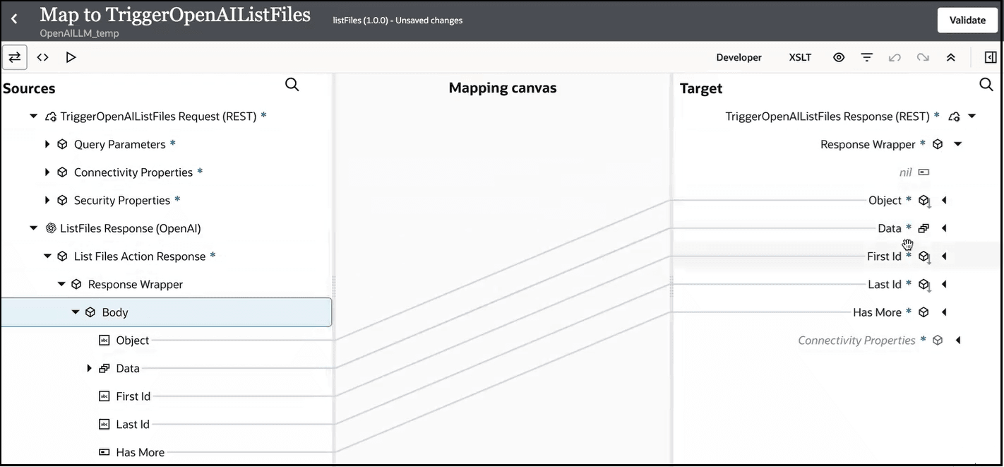

- Map the following source Body elements under
ListFiles Response (OpenAI) to the target elements.

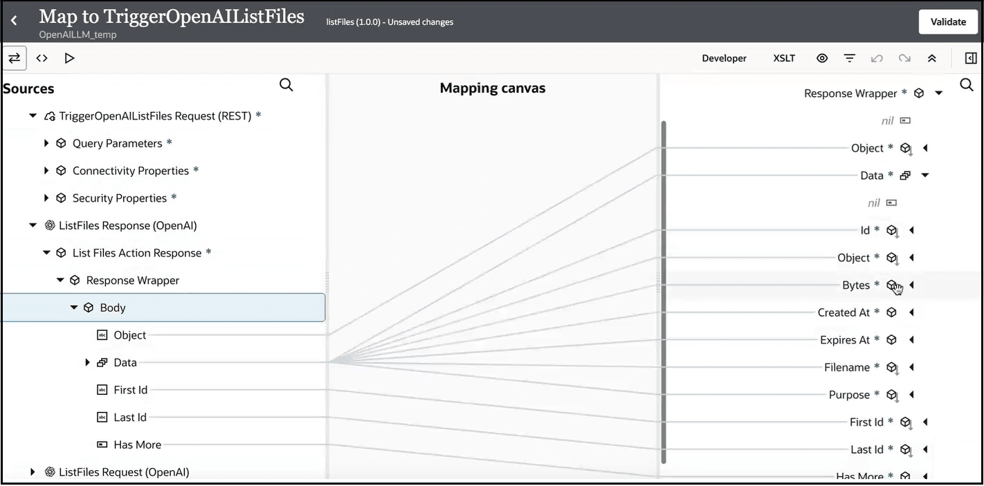

- Expand the target Data element and perform
additional mapping.

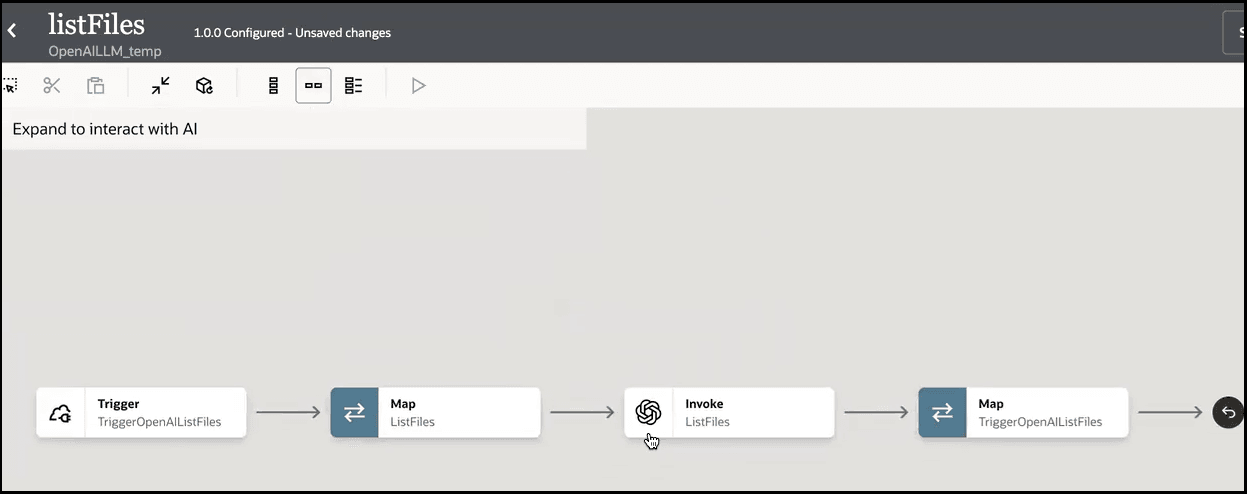

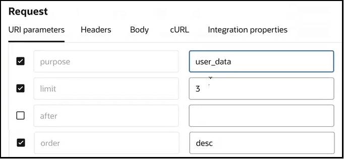

- From the Actions
menu, select Run.
The Configure and run page appears.
- In the URI parameters field of the
Request section, select the query parameters to use,
specify values, and click Run. For this example, the
following parameters are defined.

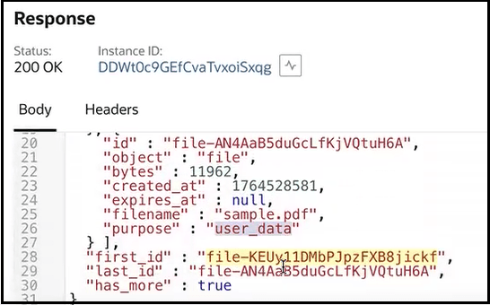

- View your results. Three entries in which
purposeis defined asuser_dataare displayed in descending order in the Response section. Here is a small portion of the output. Note that the original ID of the file uploaded (first_id) in Upload a File is automatically displayed.
