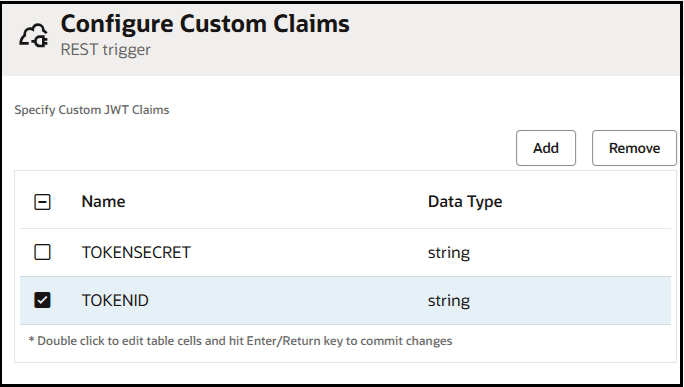

    2. On the Custom Claims page, add custom JWT claims for token secret and token ID. These claims must also be defined in the Oracle Cloud Infrastructure Identity and Access Management instance.
      The Configure Custom Claims page shows Add and Remove buttons. Below this is the Names column with values for TOKENSECRET and TOKENID and Data Type column with values of string for both.

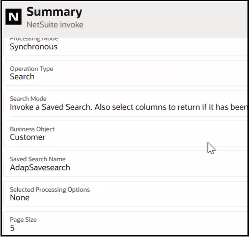

  3. Add and configure the Oracle NetSuite Adapter invoke connection in the integration canvas. Configure the adapter to address your business needs. There are no identity propagation settings that require configuration. For this example, the Summary page for the Oracle NetSuite Adapter looks as follows upon completion.
    The summary page shows the processing mode as synchronous, the operation type as search, the search mode as invoke a saved search, the business object as customer, the saved search name as AdapSavesearch, the selected processing options as none, and the page size as 5.

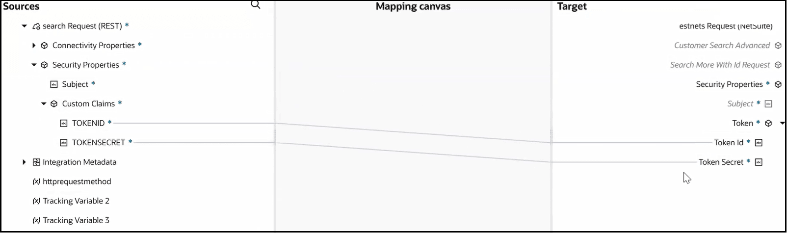

  4. Open the mapper and expand the Sources and Target sections.
  5. In the source Custom Claims section under Security Properties, map the previously defined TOKENID and TOKENSECRET custom JWT claim elements to the target Token Id and Token Secret elements.
    The target Security Properties section automatically appears whenever you create a new endpoint connection to Oracle NetSuite. The Custom Claims mappings enable the user identity to be propagated and automatically authenticated only in Oracle NetSuite. The target Token Id and Token Secret elements enable you to override the client ID and client secret values configured for the Token-Based Authentication security policy of the Oracle NetSuite Adapter at design-time.
    The Sources, Mapping canvas, and Target sections are shown. The source TOKENID and TOKENSECRET elements are mapped to the target Token Id and Token Secret elements.
    • You must use the Custom Claims elements for user propagation with Oracle NetSuite. Do not use the Subject elements.
    • To make the Security Properties section visible in an already-created Oracle NetSuite Adapter invoke connection, open the Adapter Endpoint Configuration Wizard, click Continue on each page, then click Finish.

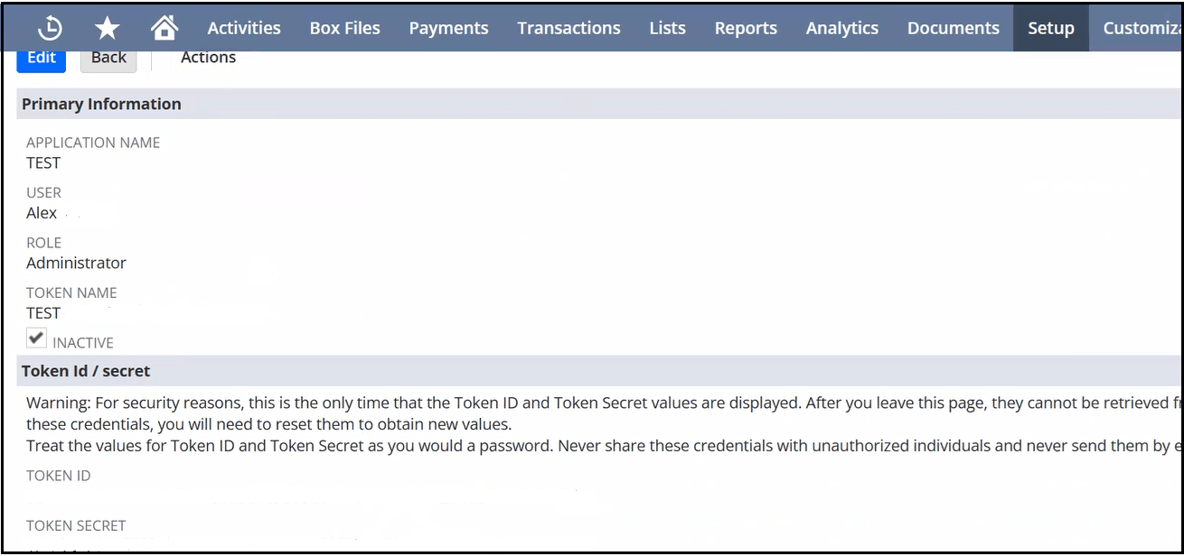

Create the Runtime Token ID and Token Secret Values in Oracle NetSuite
You must create the token ID and token secret values that you want to specify at runtime when propagating the user identity to Oracle NetSuite. These values are specified for the token ID and token ID parameters at runtime.
  1. Sign in to Oracle NetSuite.
  2. Click Home in the main menu.
  3. Scroll down on the left side of the page.
  4. Click Manage Access Tokens under the Settings section.
  5. Click New My Access Token.
  6. Select ICS Integration Record from the Application Name list, and click Save.
    The token secret and token ID values to specify at runtime are created (obfuscated in the following image for security reasons).
    The page shows tabs for Activities, Box Files, Payments, Transactions, Lists, Reports, Analytics, Documents, Setup (which is selected), and Actions. Below this are tabs for Edit (which is selected), Back, and Actions. Below this is the Primary Information section, which includes fields and values for Application Name, User, Role, Token Name, and Inactive. Below this are fields and values for Token ID and Token Secret.
  7. Copy the token ID and token secret values for specifying at runtime.

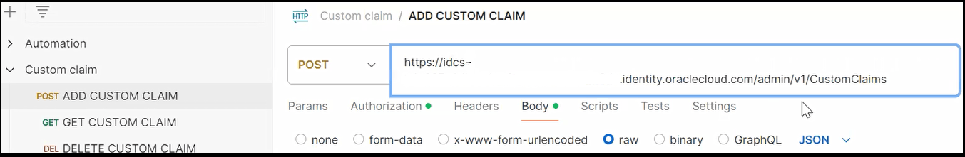

  1. Open a tool to run the integration. For this example, Postman is used.

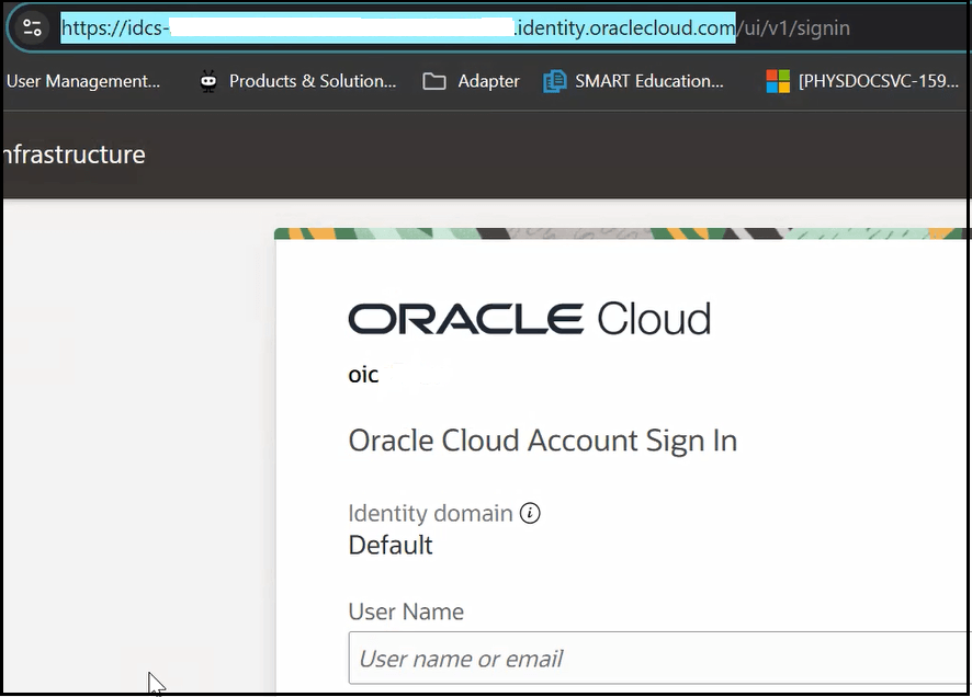

  2. Go to the Oracle Cloud Infrastructure Identity and Access Management login page and copy the URL that begins with idcs-.
    The URL for the Oracle Cloud Account Sign In page is shown. The URL includes a prefix of idcs- at the beginning.
  3. Paste the URL into the Post field in Postman.
  4. Add /admin/v1/CustomClaims to the end. This action associates the custom claim APIs with the Oracle Cloud Infrastructure Identity and Access Management instance of Oracle Integration.
    https://idcs-URL_value.identity.oraclecloud.com/admin/v1/CustomClaims
    The Custom claim tab is expanded to show entries for Add Custom Claim, Get Custom Claim, and Delete Custom Claim. On the right, Add Custom Claims appears. The Post value has been specified. Below this are tabs for Params, Authorization, Headers, Body (which is selected), Scripts, Tests, and Settings. Below this are selections for none, form-data, x-www-form-urlencoded, raw (which is selected), binary, and GraphQL. A JSON list appears to the right.

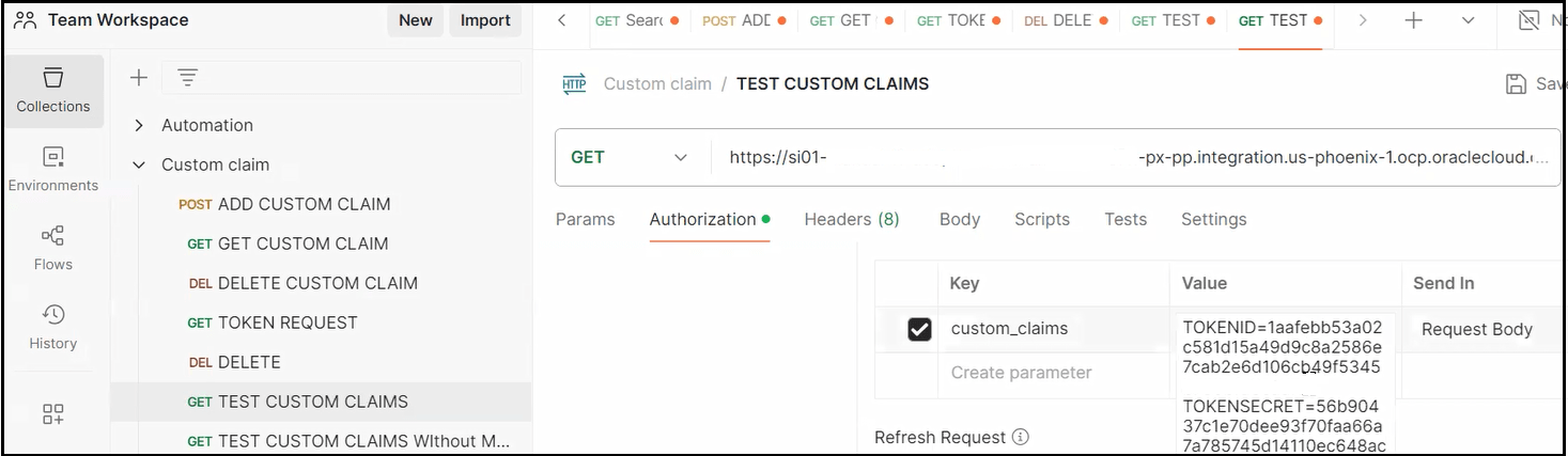

Run the Integration Using the Runtime Token ID and Token Secret Values
  1. In the Get field under Authorization, enter the URL of the integration to execute.
  2. Click the custom_claims key, and enter the runtime token ID and token secret values you obtained in Create the Runtime Token ID and Token Secret Values in Oracle NetSuite. The actual token ID and token secret names (for this example, TOKENIN and TOKENSECRET) must match with those names you specified on the Custom Claims page during design time. The custom_claims key is optional and can be added when making an access token request.
    The Team Workspace appears on the left. Connections is selected. There are other options for Environments, Flows, and History. The Custom claim tab is expanded to show entries for Add Custom Claim, Get Custom Claim, Delete Custom Claim, Toke Request, Delete, Test Custom Claims, and Test Custom Claims Without. On the right, Test Custom Claims appears. The Get value has been specified. Below this are tabs for Params, Authorization (which is selected), Headers, Body, Scripts, Tests, and Settings. The key field shows the custom_claims key, which consists of values for TOKENID and TOKENSECRET.
  3. Click Get New Access Token, then Proceed, and then Use Token.
    If the connection to the Oracle NetSuite endpoint is successful, the user is available. The token secret and token ID of the user were successfully propagated to Oracle NetSuite.
    If you specify an incorrect token ID or token secret, that user is not available and you receive the following error. Verify that the values you entered for client ID and client secret are correct.
    Invalid login attempt
