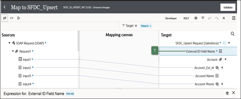

  7. In the mapper, map the source SOAP Request (SOAP) input element nodes to the target SFDC_Upsert Request (Salesforce) input payload. For this example, map input1 to Account_Ext_Id and input2 to Account Name.
    The mapper shows Designer, Code, Test, and Recommend tabs. To the right are the Developer, XSLT, View, Filter, and four links. Below is the Sources, Mapping Canvas, and Target sections. Below this is the Expression Builder section. The actual source-to-target mappings are described above the image.
  8. Click External ID Field Name, and then click Create target node. The Expression Builder is displayed.
  9. Add the same field API name that is set as External Id field in Salesforce. For this example, the following value is added to the Expression Builder:
    Account_Ext_id_c

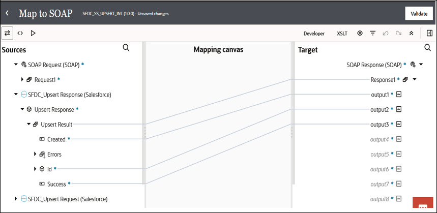

  10. In the mapper, map the SFDC_Upsert Response (Salesforce) element nodes to the SOAP Response (SOAP) element nodes:
    • Created to output1 (returns true if a new account is created and false if an account is updated)
    • Id to output2 (returns an account ID that is created or updated)
    • Success to output3 (returns true if the operation is performed successfully)
    The mapper shows Close and Validate buttons in the upper right. Below at the lower left are the Designer, Code, Test, and Recommend tabs. To the right are the Developer, XSLT, View, Filter, and four links. Below is the Sources, Mapping Canvas, and Target sections. Below this is the Expression Builder section. The actual source-to-target mappings are described above the image.

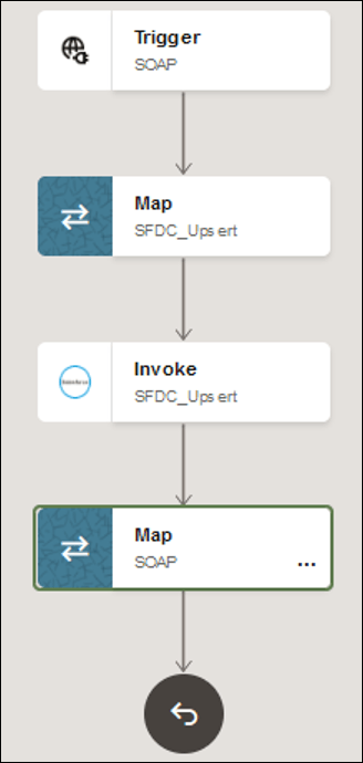

  11. Click Validate, and then click Close. The completed integration looks as follows.
    The integration shows a SOAP Adapter, mapper, Salesforce Adapter, mapper, and return icon.
