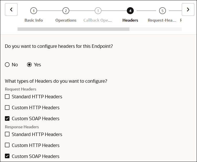

Configure custom SOAP headers and specify a valid schema from which an element can be selected as a custom SOAP header in the Adapter Endpoint Configuration Wizard:
  1. On the Header page, select Yes for Do you want to configure headers for this Endpoint?.
  2. For What types of Headers do you want to configure, select Custom SOAP Headers in the Request Headers and Response Headers sections, as applicable.
    Description of oic3-soap-cust-hdr.png follows
