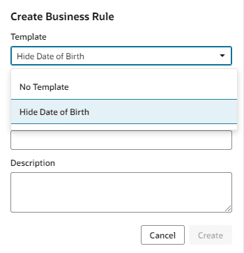

  2. In the business rules editor, click Create Rule next to Form Rules to open the Create Business Rule dialog box.
    Rather than starting from scratch, you can duplicate an existing collection rule and use it as the basis for a new rule. To do this, right-click the rule, and then click Duplicate.
  3. Select Regular in the dialog box.
    You can choose If/else or Switch in the dialog box to add conditions to when rules are evaluated. See Add an If/Else Rule and Add a Switch Rule
  4. Enter a label, id, and description for the rule.
    The id is generated automatically based on the label you enter, but you can modify the id if you wish. The description field is not required, but it can be helpful when you later try to understand what a rule is doing, especially when there are many rules.
  5. Click Create
